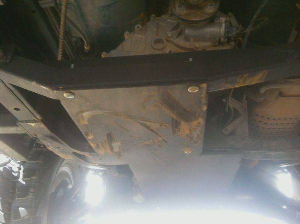

  16. Apr 22, 2013 at 9:51 AM
    #1516
    Slodgetto
    Slodgetto [OP] Über Posre
    Jan 18, 2011
    #49483
    9,276
    Silas
    Welp, the skid plates pass inspection! :woot:
  17. Apr 22, 2013 at 9:53 AM
    #1517
    IDtrucks
    IDtrucks Unhinged and Fluid
    Jun 2, 2010
    #38254
    23,536
    Mark "Buck"
    Jackson Wyoming
    96' X-Cab 4x4 TRD Off Road Clusterfuck
    JVC Deck, 10" sub mountd in rear seat cubby, 2 LED off road lights mounted in grille, amber raptor style grille lights, LED rock lights, square led bed light, custom made fuse block tray, 12 blade Blue Sea fuse block, 100a marine circuit breaker, black plasti dipped full grille, tinted tail lights + third, Uniden 520 with 4' firestik, Bilstein 5100s with 620lb Eibach coils, Diff drop, Chevy 63 leaf swap, TG creeper joints, 14" triangulated biletein 5125s, 8" extended steel braided brake line, TG Rock Sliders, CBI Moab 1.0 front bumper, custom fabbed bed rack, full TRD E-Locker axle swap and matching re-gear with custom stand alone wiring circuit, 29 spline pinion flange from an 06 wishbone runner, tubbed for 35x12.5" general grabbers on Ultra type 181 wheels, crush sleeve eliminator, Mini ARB compressor, front ARB locker, garage fab aluminum front skid plate, custom built high clearence rear bumper, removable mothafuckin doors
    Silas, when you sell this pig promise us that in the near future when you get back into 4x4 land you buy another taco (preferably for cheap) and just jump right to building a solid axle crawler?
