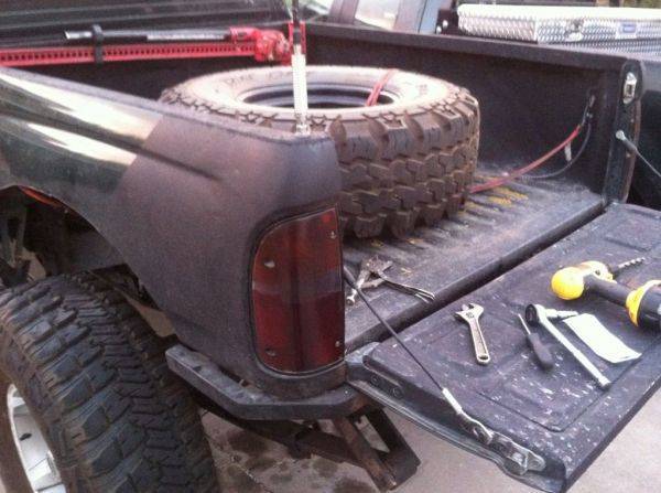

    A lot of crap still has to get done in less than a week...... this'll be fun

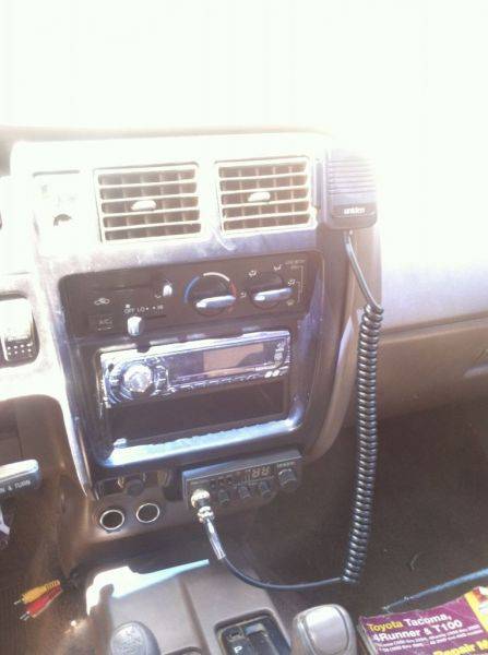

    Some of the New Mexico guys noticed that I needed a CB radio for Moab and they all pitched in and BOUGHT me a good one along with all the necessary attachments!! :eek: The surprised me with it all at one of our local meets a few nights ago.
    Installed with the great help of tomtom! Will get it tuned Sunday, and all will be good to go.

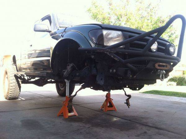

    Too late, I started this project almost a week ago.... :eek: I'm finding you're right though. I'm about ready to pull my hair out. I should have waited until after Moab, but I wanted to get an alignment before the trip, and the old bushings were so far gone that some of them were loose, and they couldn't get a good alignment without replacing the bushings first.
    My truck has looked like this for the past several days now, and I'm getting depressed!

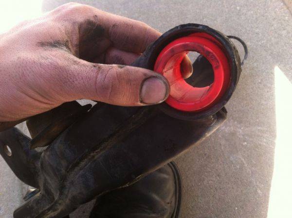

    Here's my problem.... I didn't realize the new bushings a got (energy suspension) DON'T come with everything! :mad::facepalm: (I shoulda read the instructions first.) I got the old bushing pressed out, threw them away, went to install the new ones, and realized that I was supposed to keep the outer sleeves from the old bushings in installed. Also, for some reason, the new bushings came with new upper bushing inner metal sleeves, but not lower... Apparently I was supposed to keep those too!!! Stupid.. :mad:
    See how loose it is without that outer sleeve?
    I didn't come up with anything at the junkyard this morning.... I called all Toyota stealerships within 60 miles and no one has the bushings in stock. They said they could order them but they won't arrive until Wednesday. (and besides, they want $62 per lower bushing, and I'd have to buy the complete UCA assy at $200 something...........)
    At this point, I'm thinking about just running some welds on the inside of the control arm eye's until the new bushings fit tight, and then hopefully I can find the lower bushing metal sleeves from a hardware shop...... that's probably a long shot, but it's all I can think of.

    Yea looks like you screwed yourself. I would NOT run weld in there. No way you could get it to fit right and smooth and you'd end up ruining those bushings.
    Shitty deal man :eek: even if you get them by Wednesday wouldn't you still make it??

    dude! i wish u wouldve said something! i tried putting those bushings in as well in the stock uppers.... i gave up when i found out u had to use the outer and inner sleeves. so freakin stupid, there's no way.... junk yard didnt have any control arms tho huh?
    i just bough new oem bushings for lowers and bought ucas when i ran into this problem.

    Junkyard only had 5 lug tacomas and the only correct year 4runner already had the LCAs stripped. :( It did have the UCAs, but the shock towers were all bent up from what looked like a hard front end crash and I didn't want to risk getting a bent control arm.
    Chad has his old uppers from his SAC. I'll probably just drive to a few hours to grab those and then get those OEM LCA bushings ordered form Toyota. Don't see any other viable options at this point.

    So if I overnight the Rock-auto version, apparently the soonest it could be here is Wednesday. x__x
    It definitely has the inner sleeve and both washers that I need... but I see no outer metal sleeve. What do you guys think? It sorta looks like it replaces the outer sleeve...
    I've got some lower bushings on order form Toyota just in case, but if these are the right ones, they're way cheaper and will arrive at the same time if not sooner...
    Anyone know if the outer sleeve is supposed to be integrated into the bushing? If so, (I'm thinking it is) the rock auto guy said they're bushings should work just fine and I won't need the outer sleeve.
    Did you happen to notice on your new, OEM bushings, Jace? Did they come with the outer, metal sleeve, attached? Mine old ones were very shot and it was hard to tell...

    yes. its all one piece. inner sleeve is probly 1/2 in id. then ur rubber, then ur outer sleeve. i would honestly just order the rock auto ones and press them in. dont bother with the poly bushings.... more headache than its worth. just get to moab!
