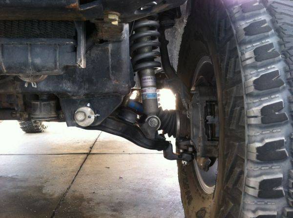

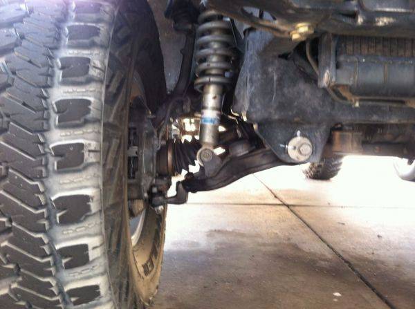

    so wait what happened that your CAa and cvs are at such bad angles? you bump up the spring perch? new coils? because of the bushings?

    Yeah, I was only sitting at 2" of lift up front with the billies and eibachs on the bottom level, so I bumped them up to the middle perch to theoretically gain 1 more inch of lift.

    I wish there was a .75 notch. That woulda been much much better. 1" on the billies with the eibachs really makes close to 4" lift or more cause the eibachs are so long.

    how are you only at 3" of lift? those things are supposed to be 3 with a bumper

    When you do a lot of wheeling it puts a lot more stress on them, wearing them out quicker.

    Well ya I got that, but it dropped a whole inch? He hasn't even had em that long.

    Don't know what to tell ya, but my hub to fender measurements (of course keeping in mind that I've removed 2") were consistently 1-1.25" shorter then other guys with the exact same front set-up.
    I've had 'em for about 2 years, now..... and a 2nd gen had them on his truck for about 8,000 miles (I'm the second owner), I've got a lot of weight up front, and I wheel in the rocks a lot which means a lot of cycling...

    And for reference, my hub to fender measurement was 25" at the lowest setting, and they're at 26.5" right now... which puts me at 3.5" of lift. I think it just looks like more since I cut out 2" form the fenders... :notsure: So I'm hoping they'll settle a half inch once I get the skids on and after a few more days of weight on them to get 3".
    Once they settle, and I get a diff drop on, I think the CV angles will be plenty acceptable for manual hubs. But yeah, they ain't great right now. :D
