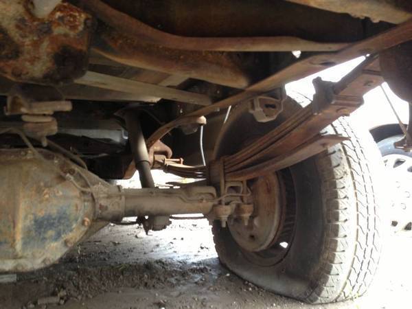

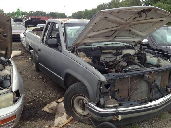

    Do you have a part number for the bushings or know what vehicle to look up for them? Also these are the 63's I'm looking at.
    4 pack with overload although they are on a 2wd truck :confused:
    The truck:

    Those are good. It was most likely a WT, they come with the 4 pack (I've read). Just an extra leaf, as long as they are 63" long (bring a freaking tape!!) you will be fine.
    You can make brackets like those? That's cool! Otherwise just buy them, they are cheap.
