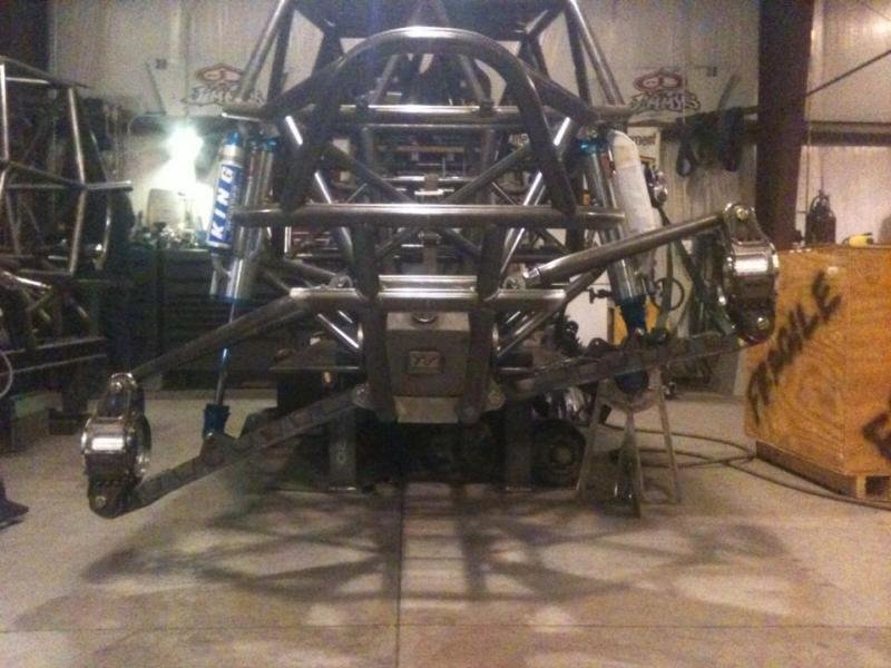

    ORLY?
    719978d1358881483-koh-2013-more-ifs-sa-b_749ecb2c15f36dec2aaaa29a82a101454d9bce22.jpg
    Alot worse than a D44 :p

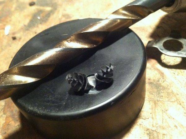

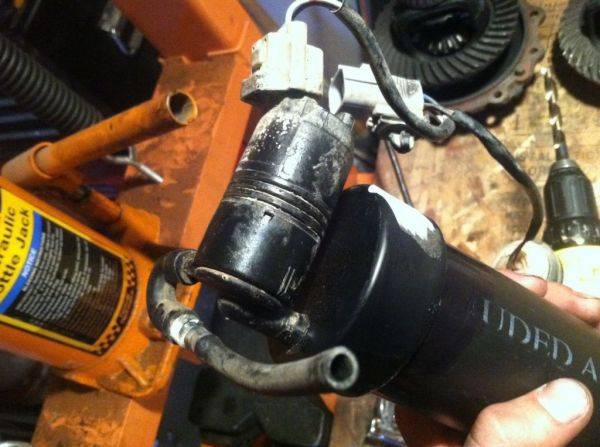

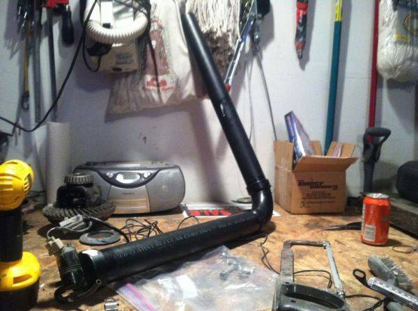

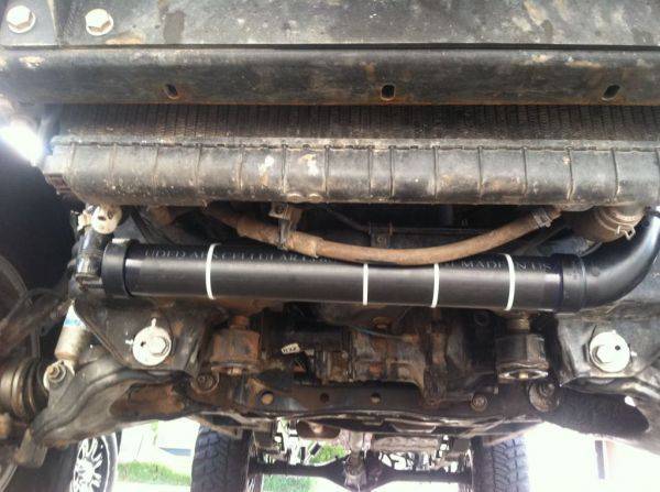

    So how bout a real update....
    Finally got around to making a windshield washer reservoir since the stock one got demolished by my tire.
    2" ABS pipe
    13/32" bit was perfect for a very tight press fit of the OE pump inlet to my resivoir.
    zip-tied in place--seems to be holding just fine, even with half a gallon of washer fluid.
