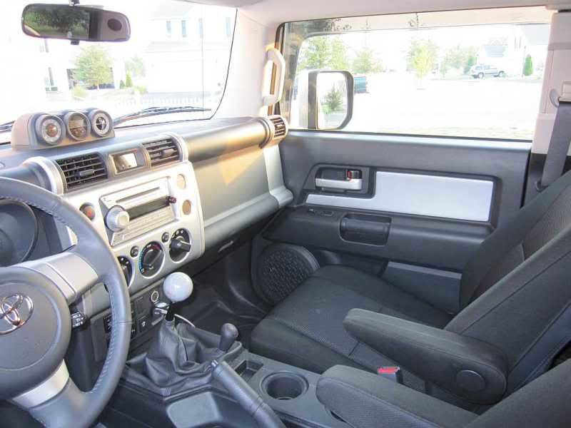

    It's the wife's T4R so it's stock
    Had the trd quick shifter in the FJ... Helped the feel quite a bit
