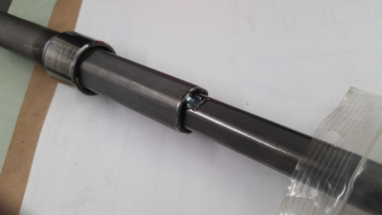

    I've jumped off in it too. I'll do two tack welds tomorrow at work and put it back together tomorrow evening. As mentioned in the writeuo, the spring on the drivers side is the toughest part of the whole thing. Once I had the two 6mm bolts and bolt near the firewall out, it helped to tap on the joint near the firewall to break it loose. Btw, I've never done anything with removing a steering wheel or column before.

    Nicely done guys! Mine has still held up all these years with two small tac welds.

    I have already tack welded mine, recently, and am not concerned that they would hold longer than the upper portion that is bolted in, in the event of a crash. But let me throw out yet another possibility. Could you put the slider in a hydraulic press and dimple one or more of the flats, in effect tightening the outer shaft onto the inner? This would keep the intended use of the slide in tact.

    Yep, I like the sound of that. I could have done that today instead of welding it but too late now. I suspect that a drilling hammer and a sharp punch might do the trick.
