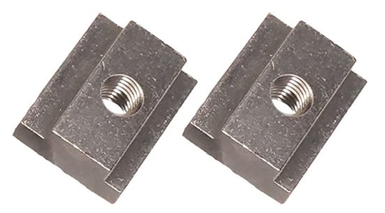

    The bolt you use should pass through whatever frame you’re bolting to the bed but not through the slot nut. Just like using unistrut or slot nuts on a milling table; the threads of the bolt should engage the threads of the slot nut but not protrude through the the nut.

    I'm thinking of these things. They stay in place because you exert outward pressure by the nut against the outer edge of the track when you tighten the bolt. You're basically clamping the outer edge of the track bewteen the flat nut inside the track and the bottom of the attachment. No way to do that with track nuts?

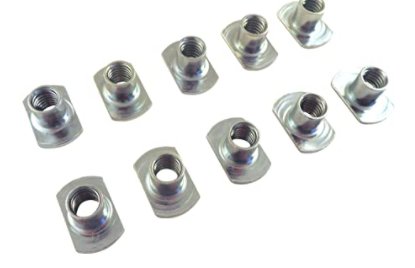

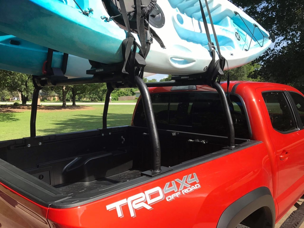

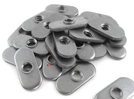

    This is what I mean by track nuts, and an application that doesn't make sense to me in the second photo. Don't they slide around in the track? Maybe they need a washer or spacer to let the bolt pull them outward when tightened?

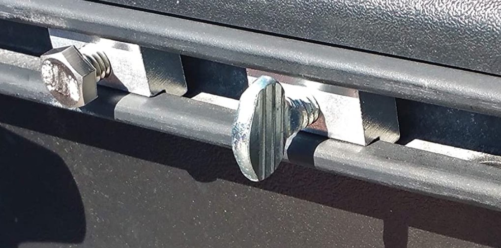

    Maybe this will help you. If you zoom in, you’ll see a bolt going through the bed bar bracket into something in the track. Hint, it’s a t-nut.
