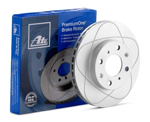

    Anybody here on TW ever put these style rotors on their trucks? Not liking the distance im travelling with the stock set up and im just about due for a new set and trying to do some homework on this. Any help would be appreciated.

    I use these on my truck, been VERY happy with their performance and how they've held up to my driving style.

    ATE makes excellent stuff. They are original equipment on BMW and other brands. These rotors are a nice upgrade. I had them on my old Bimmer and VW
