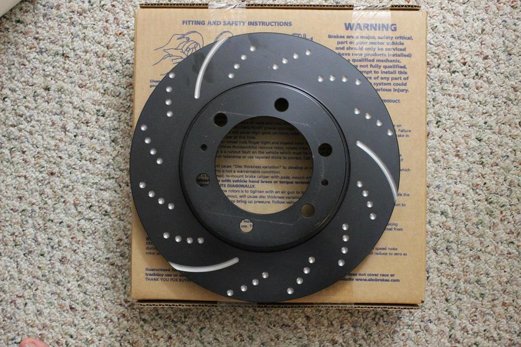

    ebc..... Comes with the stage 5 kit
  11. Nov 25, 2015 at 4:41 AM
    #31
    Sandman614
    Oct 26, 2010
    #45273
    36,013
    Tim
    Garner, NC/Boone, NC
    '06 SR5 Off Road
    The black wears off, right?

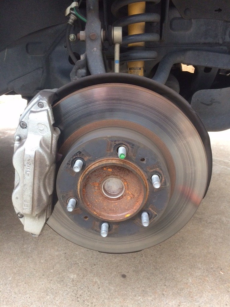

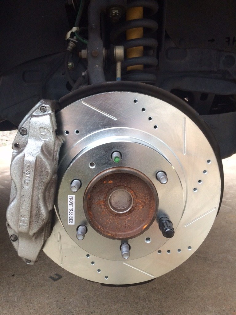

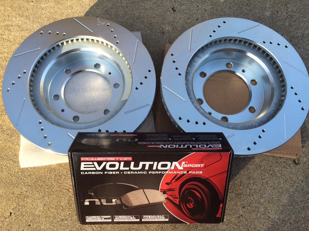

    I ended up ordering a 'PowerStop' pad/rotor kit for about $170 (#K137). I did all the research and then ordered on Amazon. Great looking stuff! Very simple brake job on my 2014 DCSB 2WD. Pop the pads out the back side of the caliper, pull the caliper off the mount and replace the rotors. Just a few Install Tips: Wash the rotors with soap and water (never use brake cleaner or carb spray on new rotors), also take a little sand paper to the hub where the rotor makes contact. Be sure to clean all the rust away so you have a perfectly smooth mating surface between the new rotor and the hub. Lastly, follow the 'break in' instructions on the brake pads. Mine called for a minimum of 5 hard stops from 45 mph to 10 mph all in a sequence. This heats the pads and puts 'material transfer' onto the new rotor. Second was another 5 medium stops from 45 mph to 10 mph. Lastly, I drove around another 15 minutes making regular stops before parking it for the night.
    End Result after driving it all weekend - - Amazing smooth brakes with a super solid pedal and plenty of Bite.
