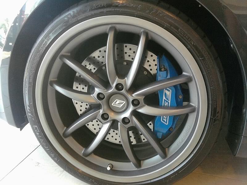

    Have you looked into StopTech? They make the Rotors for the Lexus F sport line. Kinda like the TRD line but in Lexus. And yes, they do have a shorter, more powerful braking distance than the stock brakes on the Lexus IS350. At least in MY experience.
