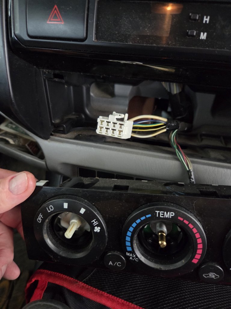

    can i bypass switch? i got wires pulled[​IMG] [​IMG] 20250829_102230 (1).jpg
    HondaGM likes this.

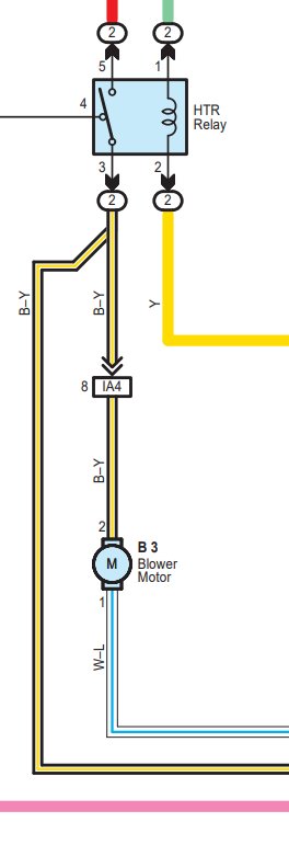

    Why row the boat when you have a motor?
    Go straight to the motor.
    If you are set on "testing" the motor for full power.
    Apply your own Power / Ground.
    Also, FWIW. The blower motor is backed by a 50A fuse. (I live life dangerously. You might not......:eek:)
    Black/Yellow - Power
    White/Blue - Ground
