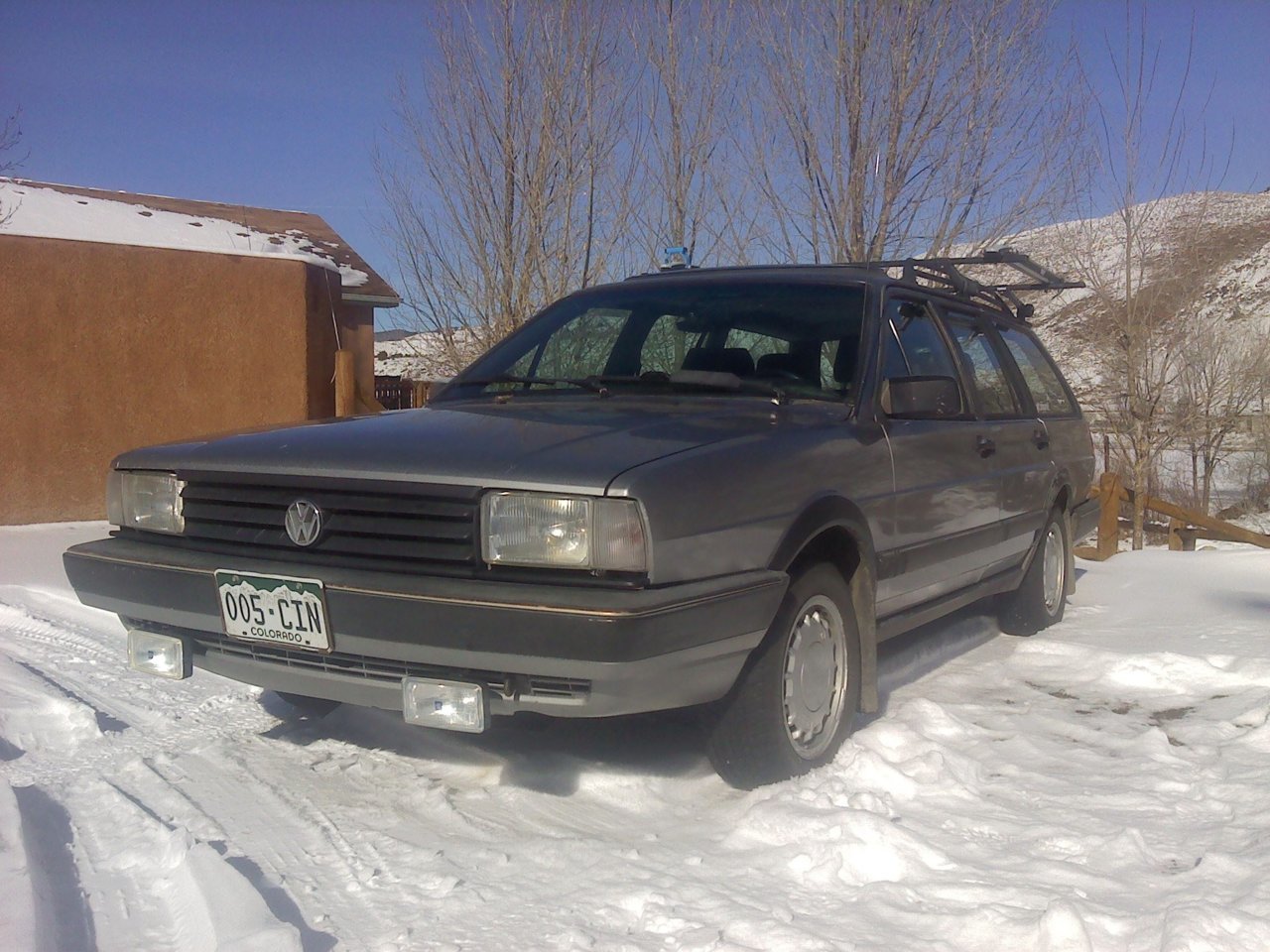

    My 1984 Audi quattro did as well as my Quantum syncro Wagon.

    Cool car, I had forgotten about those.

    I owned 14 of them. VWoA got 3750 for 1985-1988 model years pushed to Seattle, Denver, and Boston.
