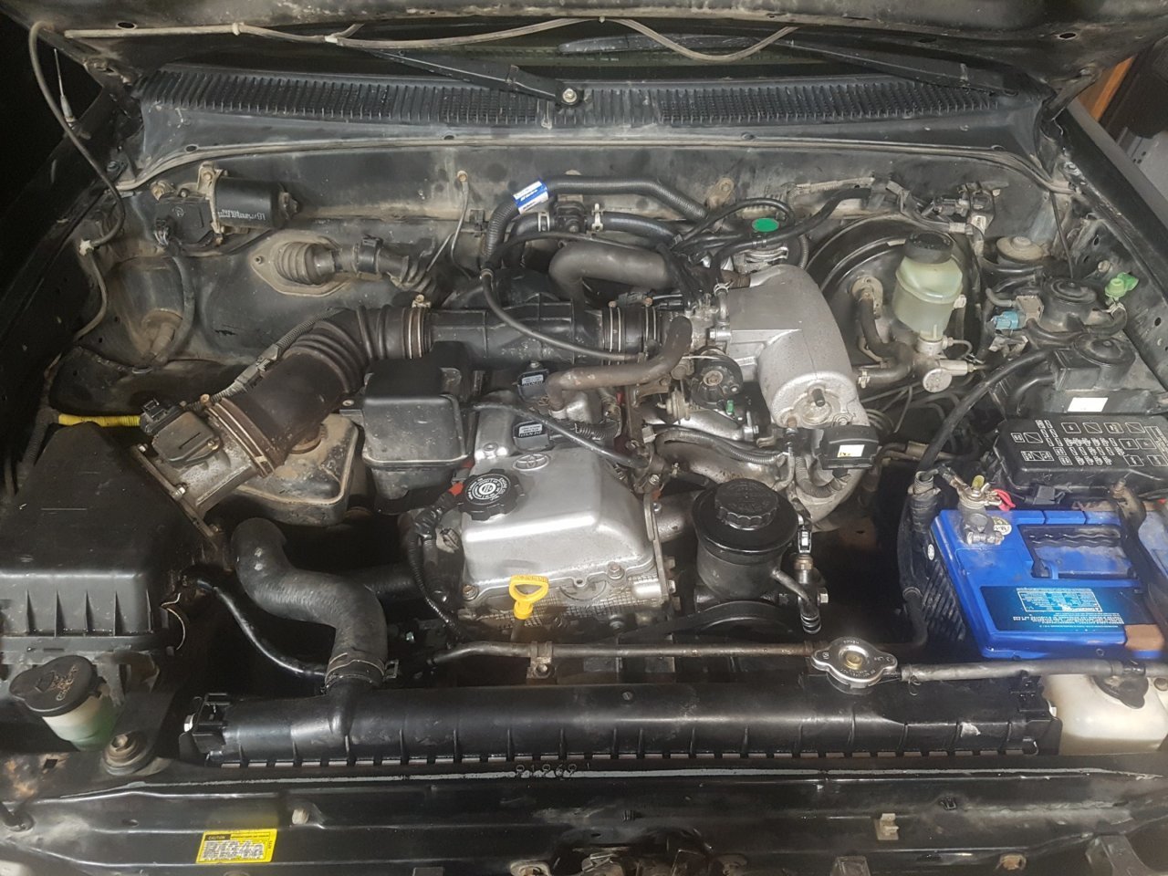

    Agreed. My 2000 taco clutch is fine in the cold, but I’ve noticed my 2007 frontiers gets slow.

    2017 MGM DCSB Off Road, 6 Speed MT, P&T
    The 2000 Tacoma's clutch shared the reservoir from the brakes though. These newer ones have the separate small clutch reservoir which makes it more susceptible to the cold.

    2000 reg cab 4x4 flatbed MT
    Mine is separate
    Wow that is different from my old 2000 Off Road.
    I wonder if it’s a v6 vs 4 cyl difference
    It probably was since mine was the V6.
