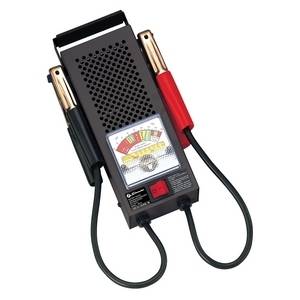

    I used a BT-100 tester to help with diagnosis
    Here are the results.
    Battery voltage with no load, 13V
    CCA rating of my battery is 710 A, did the test and got around 700-800 A
    Tested the charging system. Got a 13.8V reading with head lights off, and same reading with the head lights on. (The manual for the battery tester states, that you should do this test at 1200-1500 rpm. I did it at around 1000 rpm so I figure the results would be even better had I used the proper rpm for testing.)
    My battery tester had one more test it can do. The starter motor test; which I think (correct me if I'm wrong) tests how much current gets used up by the starter motor. I can't do this test cause I cant start the engine and read the results at the same time (tester wires are too short). I don't know how useful this test is for my situation.
