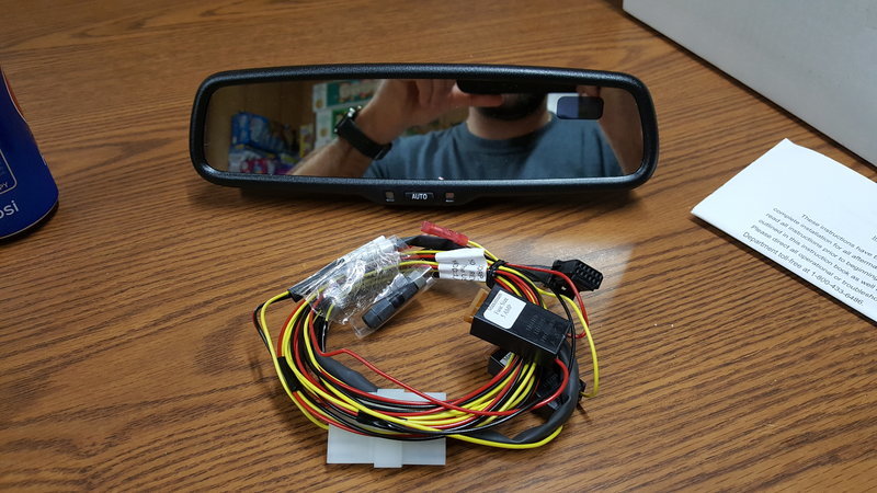

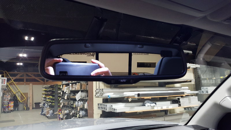

    kamil
    kamil Well-Known Member
    Oct 18, 2010
    #44839
    63
    Kamil
    Los Angeles
    2016 Access Cab SR 4x4 Manual
    THIS IS NOT NORMAL bumper sticker

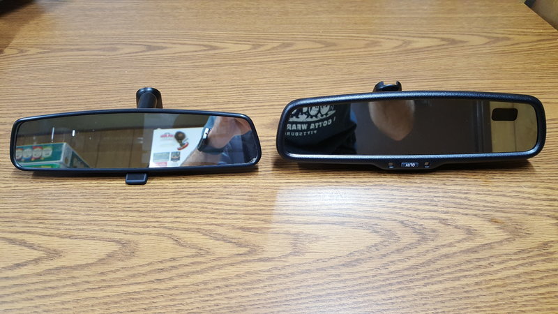

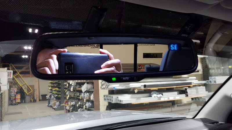

    This is a nice upgrade. Auto dimming would work great here in LA with all the crazy dudes installing high power bulbs in their lights, not to mention the crazy LED bars;-)))
    Can you elaborate on the installation? Ii it easy to attach the new mirror? Did you run the cable under the headliner along the edge and behind the driver's pillar cover? Any kind of tip would be great. Thanks

    moe2o4
    moe2o4 [OP] Well-Known Member
    Feb 9, 2015
    #148236
    7,857
    Corey
    Pittsburgh PA
    2016 SR Silver 2.7L 5 Speed
    OME 3" Lift, 32" Tires, Lots of Mods!
    Thanks @kamil. Mirror comes off with 1 torx 30 screw. You put the new one up and run 2 wires across the headliner and down the a piler and under the dash, connect the red with a Fuse tap to the ignition Fuse then the black to a good ground and the mirror turns on whenever the ignition is on. Super easy! BTW I got another mirror if your interested in it! It's a super easy install!

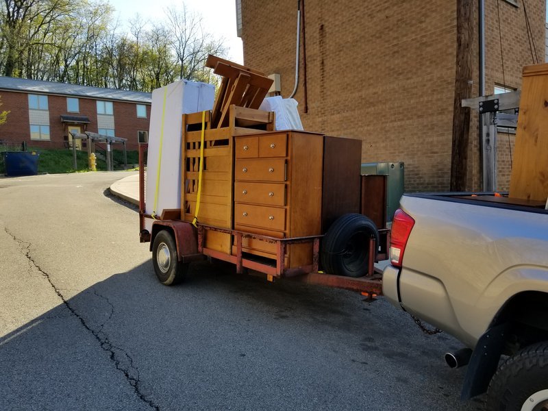

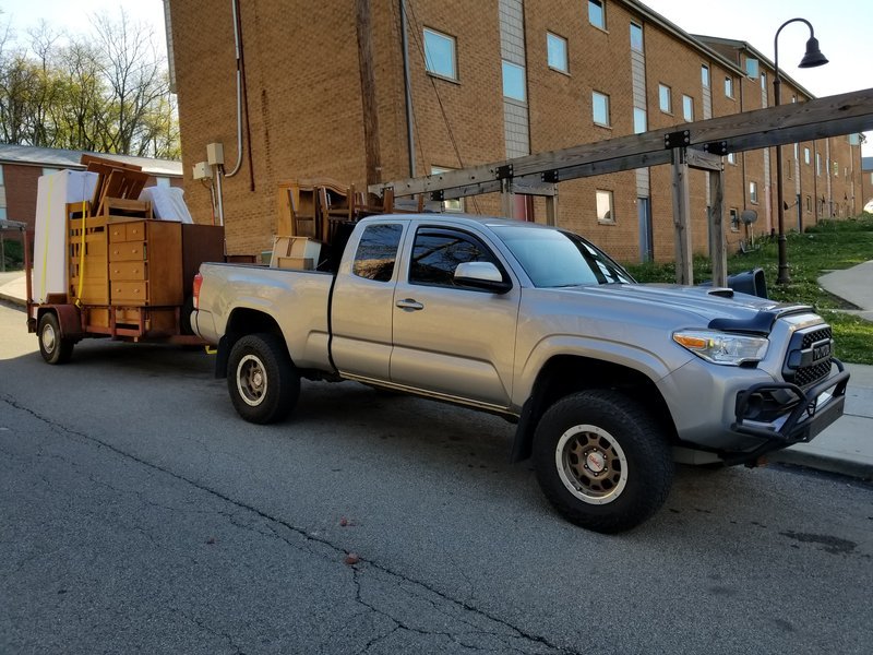

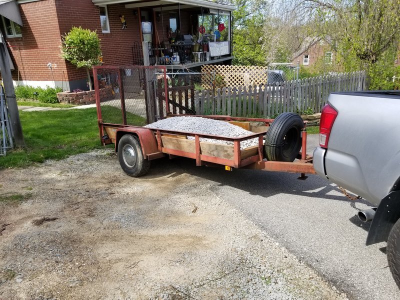

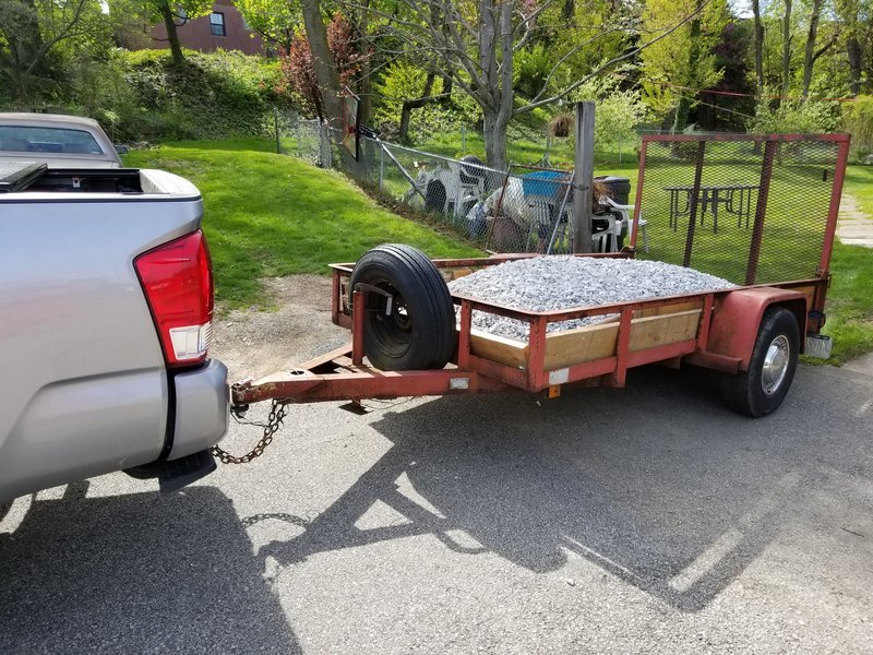

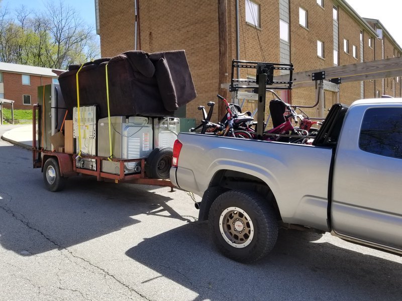

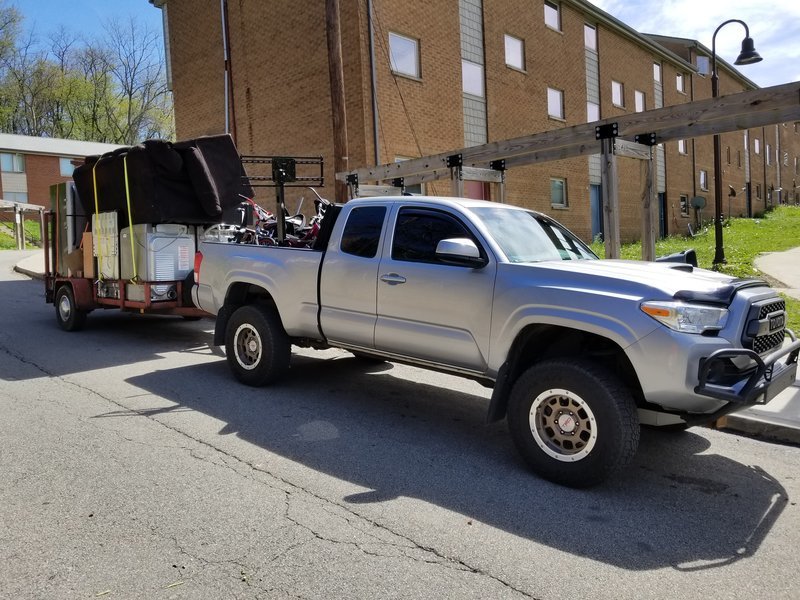

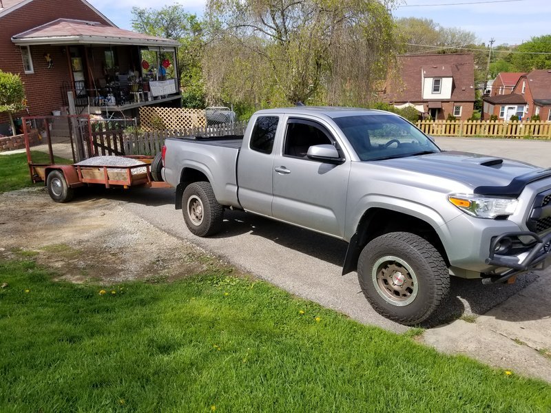

    Put the truck to work yesterday, moved two loads of household items and then later in the afternoon a ton of 2B gravel!
    Trip 1:
    Trip 2:
    Gravel:
