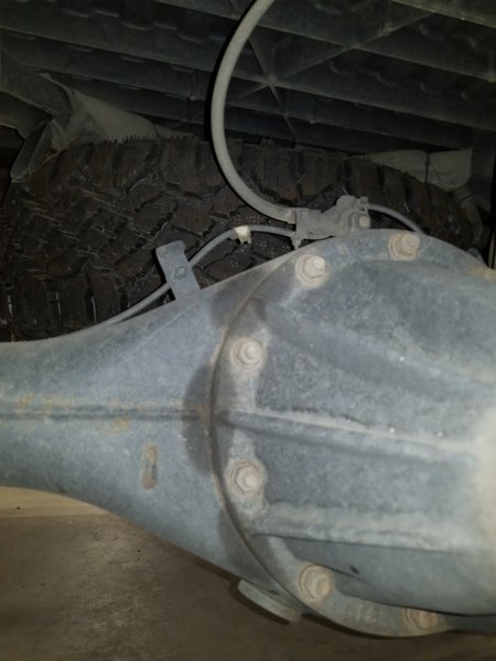

    Anything ever come of this?
    Just noticed the same exact fluid leakage/marks under my ‘17 SR with about 35k miles on it. I want my dealer to replace the seal under warranty if it is and check my diff fluid too.

    had to deal w/ exact same issue on my '17. It showed up around 1500 miles or so, brand new. Torquing bolts didnt work so dealership took it apart and used gasket maker on it. At 40k now, dry as a bone. And i think your warranty is 60k, but dont quote me on that. Good luck!

    Thanks man! It’s CPO and still within the 1 year/12,000 mile full coverage warranty too.
    Did they mention anything about being low on diff oil or anything related after tearing it apart?

    nah, not low at all. It looked similar to yours, just a little diff sweat. Truck could have gone its whole life w/o it being addressed, probly. I just had a really hard time knowing ive got a seeping diff on a brand new truck!

    Aha my same exact thoughts and gives me an excuse to make them address it and look at it without any push back
