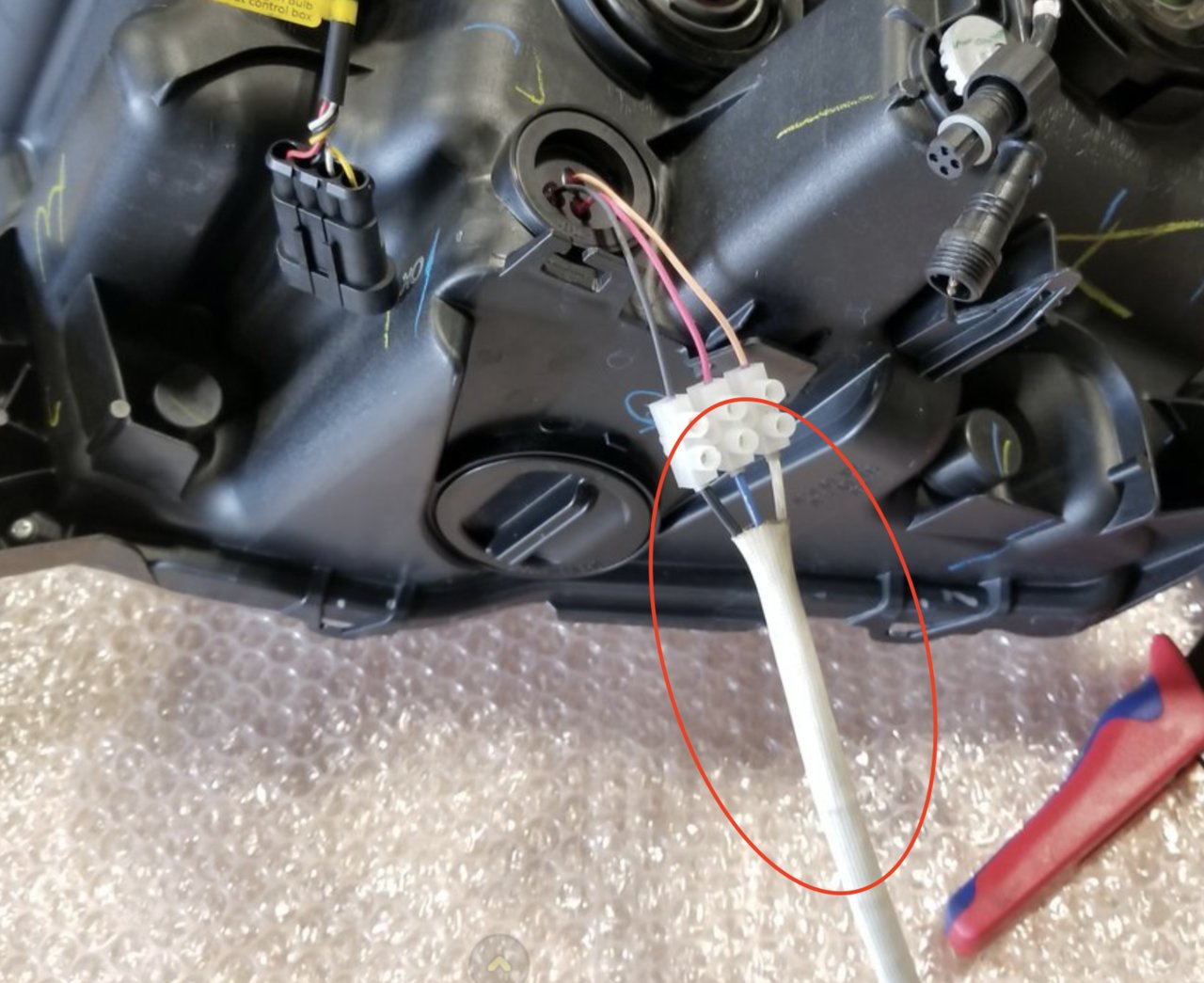

    Moe, can you help me figure out where do you connect the DRL ?

    May 4, 2020
    #326781
    Rhino
    2016 Tacoma SR5
    I have a question regarding page #530 about the wires that you had added the 3 wire strip. Where do you connect the strip to? Is it to the existing DRL wires or is it a separate switch? I have a 2016 SR5 and I'm going to be adding 2019 TRD Offroad headlights with the DRL. Don't want to "blow" it up LMK Please

    Hey guys,
    I ran the DRL to a separate switch and gave it 12v power off another accessory. One wire is for the low light setting and the other is for the high setting and the third wire is power.
    Corey

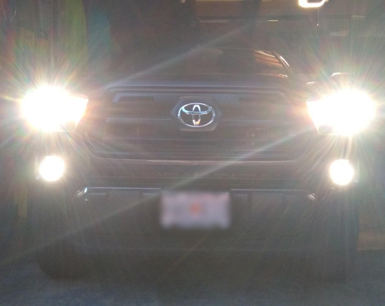

    Ionic running boards Curt trailer hitch Wiper motor mod Fog Light mod Gator bed mat Gator SF1 Pro Tonneau cover P265/70R16 Toyo Open Country A/T Moto Metal Wheels
    Finished the fog light mod last night, big thanks to moe2o4 for the right up, i had no idea what i was doing but in the end they work.Point Blur_Aug032020_203719.jpg

    I’m about to do this to my 2020 SR5, what did you connect those wires to? I get cutting off the connector, but then what do you hardwire those Bare wires to?
