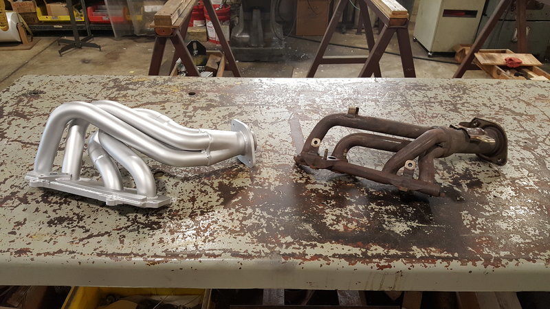

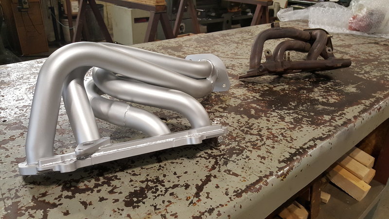

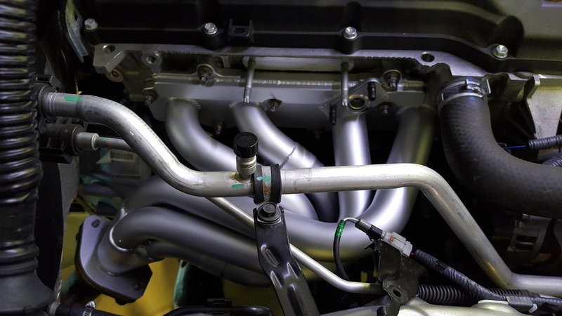

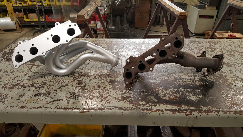

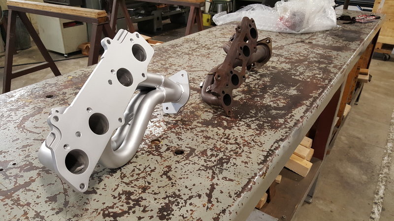

    The LCE Performance Header arrived this morning, can't wait to get it on!!!

    I like how thick the flange looks. Is it about 3/8"?
    moe2o4[OP] likes this.
  5. Jul 12, 2016 at 6:11 PM
    #125
    moe2o4
    moe2o4 [OP] Well-Known Member
    Feb 9, 2015
    #148236
    7,849
    Corey
    Pittsburgh PA
    2016 SR Silver 2.7L 5 Speed
    OME 3" Lift, 32" Tires, Lots of Mods!
    Yep its 3/8"!!!

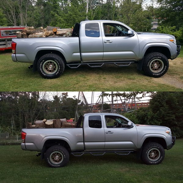

    Tested out my new firestone ride rite air bags I installed paired with some dakar leaf springs and a little 4 cylinder power! Top picture is just with the Dakar leafs and the bottom is with the Dakar leafs + firestone ride rite air bags! The bags have 50 lbs. of air in them!

    @moe2o4 just curious that wood is for burning on winter???

    Good winter wood is Cherry, locust, oak! They are all good hardwoods for burning in the winter!

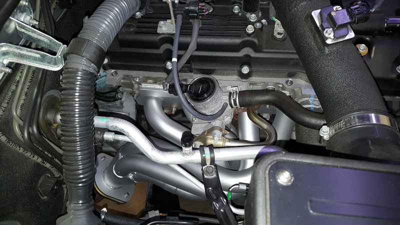

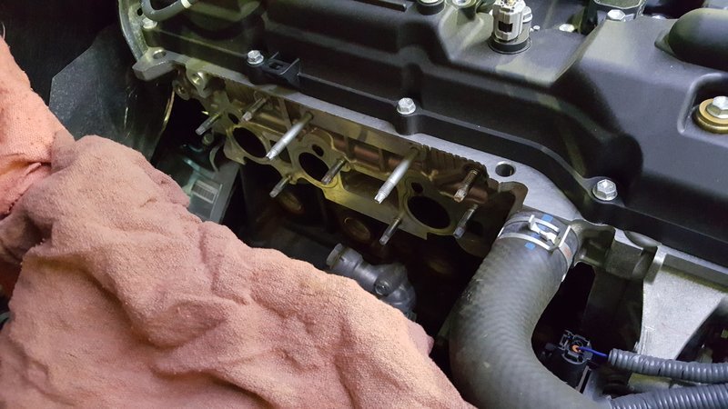

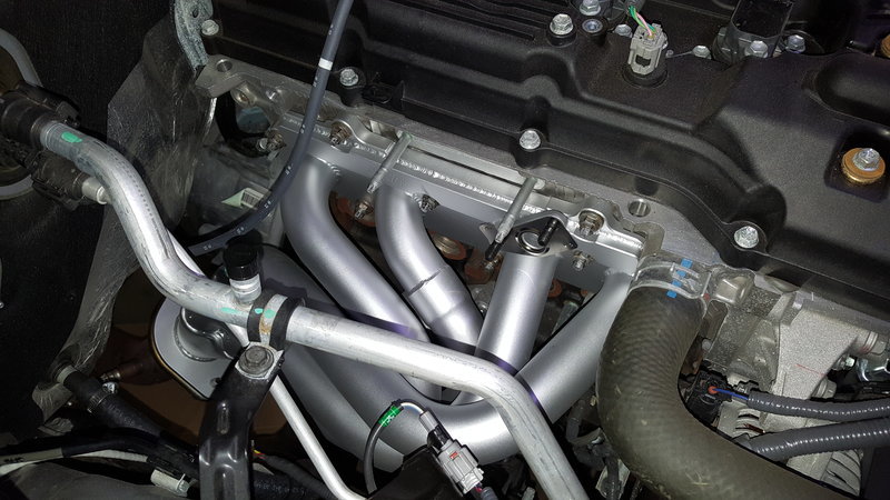

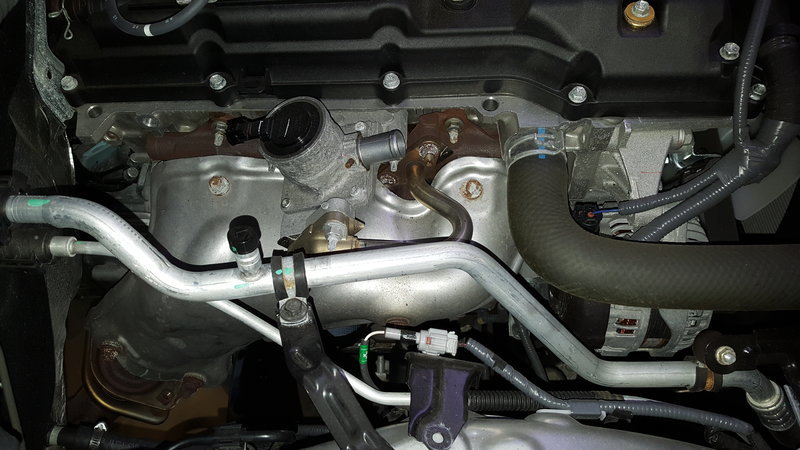

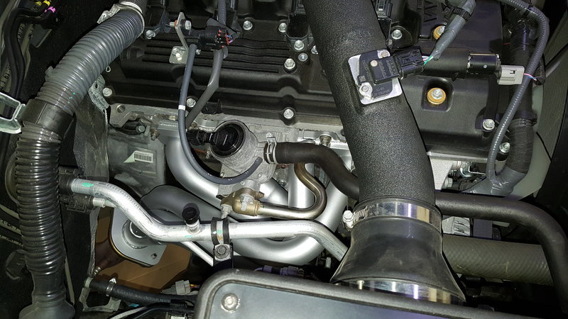

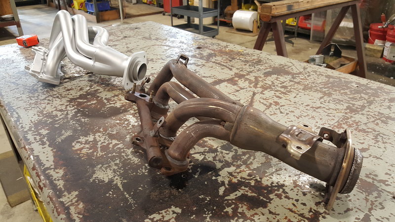

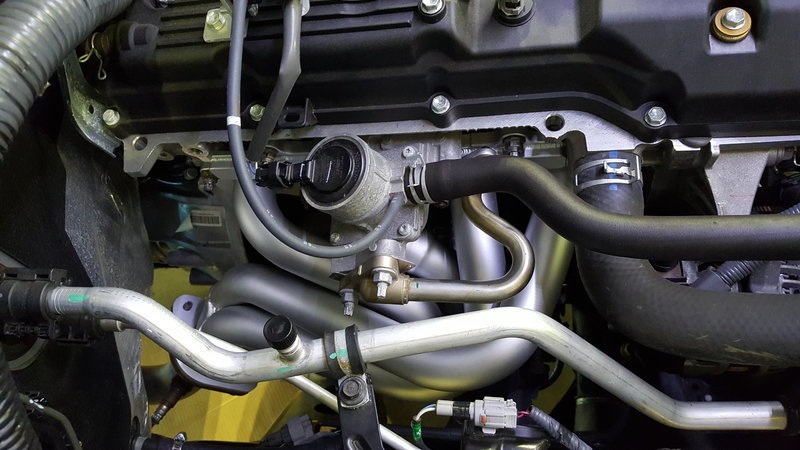

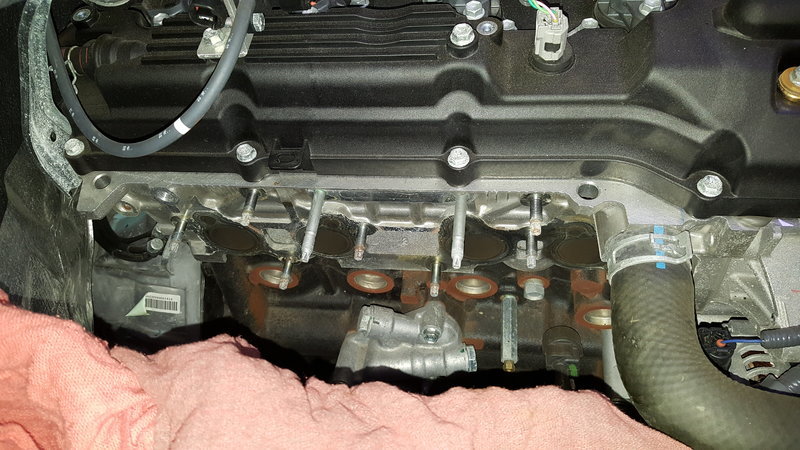

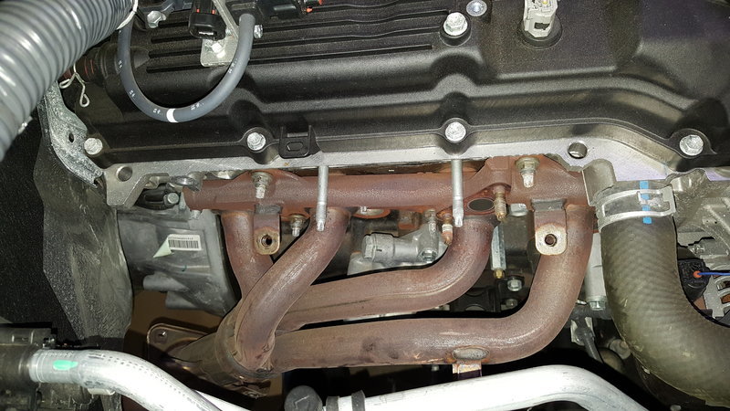

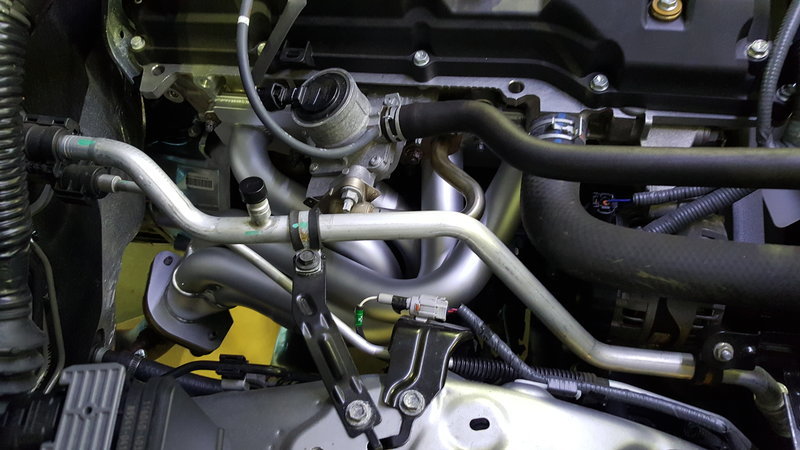

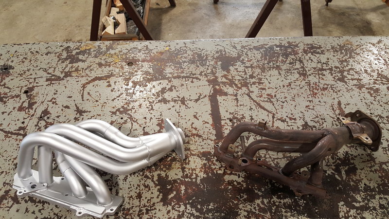

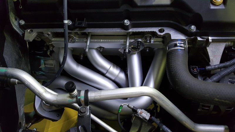

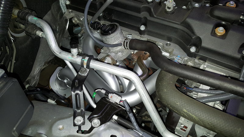

    So I got around to installing the new LCE Performance Header today. With the stock header on the truck I was watching the torque on my ultra Gauge just to see if I notice any differences when I install the new header. So after that being said on the stock header at running temperature the torque value was averaging 17 at idle. Now with the new header at running temperature it's averaging 24.5 torque at idle. When running 2nd gear up to about 4500 rpm's then shifting the torque topped out at about 117 on the stock header and now with the new header it tops out at 131 torque at the same rpm in second! But the final test will be to get it back on the dyno sometime this week and get the real numbers!!!

    Attachment flange being that thick tells me the header is aluminum, correct?
    moe2o4[QUOTED][OP] likes this.

    I know its not as pretty but you shouldve wrapped it in heat wrap! Cast iron exhaust manifold asorbs heat better to keep it from going in engine bay, and it has a shield. Lots and lots of sensitive electronics under that hood. Just my two cents, still loving the build. Keep it up.
