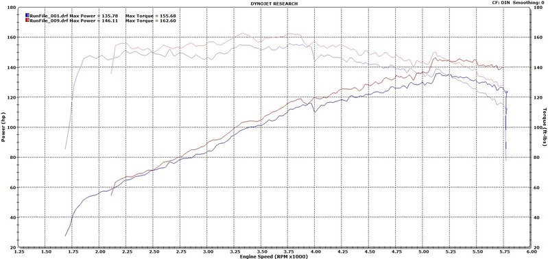

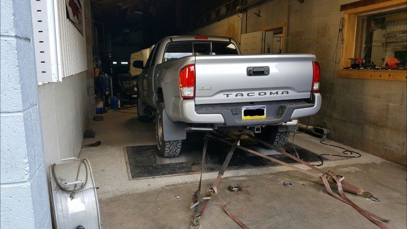

    So today I ran the 2016 SR 5 Speed 4 Cylinder on the Dyno for the final test after the new LCE Engineering Header. So here are the results!
    You have to take the #'s i got and add 20% for the chassis Dyno!
    So the stock truck ratings are 159 hp & 180 ft. lbs of torque.

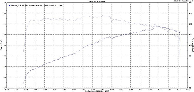

    Looks like with the AFE Pro Dry S Cold Air intake & Stock Exhaust I gained 3.94 hp & 6.82 ft. lbs of torque.

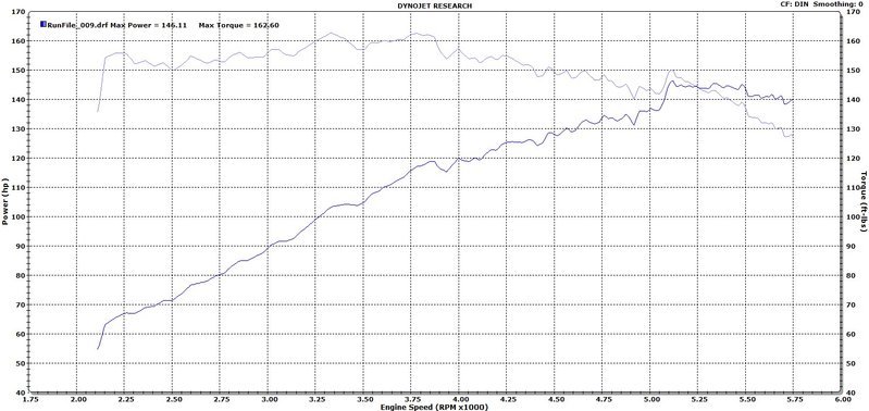

    Then the gains from the LCE Performance Header & Stock Exhaust are 12.39 hp. & 8.30 ft. lbs of torque.
    So overall with my AFE Pro Dry S Cold Air intake & the LCE Performance Header & the stock exhaust I gained a total of 16.33 hp & 15.12 ft. lbs of torque. Its defiantly noticeable with running the LT 265 75 16 tires and my 3" lift.
    This run is with the Stock Header & the AFE Pro Dry S Cold Air intake:
    This is the run with the LCE Performance Header & the AFE Pro Dry S Cold Air Intake:
    Both the Dyno runs combined:
