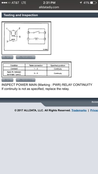

    Power window relay test. Seems like this would only be more useful is the window wasn't working at all but thought this might help if you want to test it.
    cooper4x4[OP] likes this.
