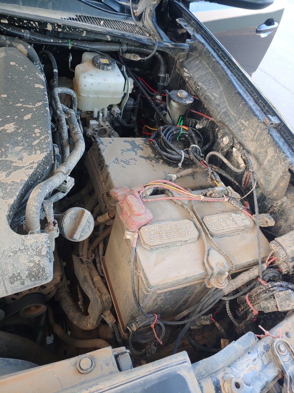

    Crossed a river. Battery or starter maybe got wet? Truck is slow to turnover now and one time just "clicked," then started. 2019 25k miles.

    I'd start by cleaning the battery terminals. If that doesn't fix it, follow the heavy wires to the starter and look for potentially dirty connections.

    This^ and also test and load test the battery.

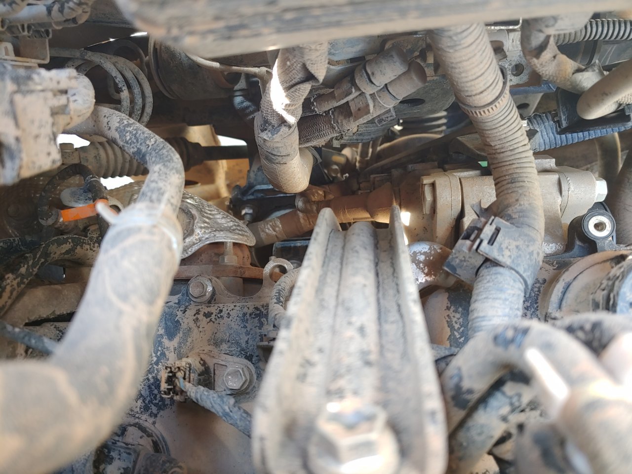

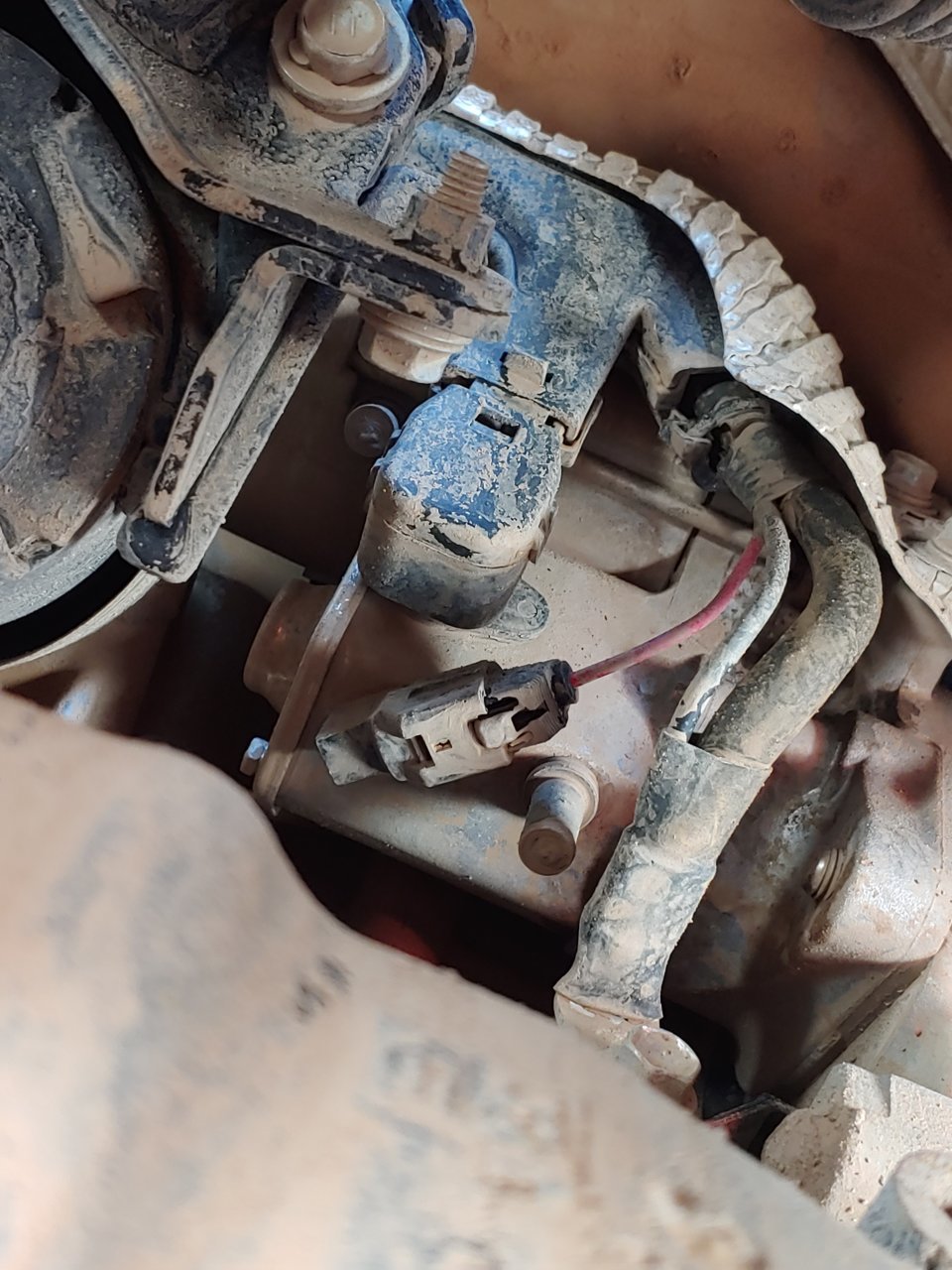

    Starting and then not starting can sometimes be a loose cable. Or maybe your starter is full of mud and not making contact. If its not starting, maybe give it some hammer tappy tap taps and see if that helps.
