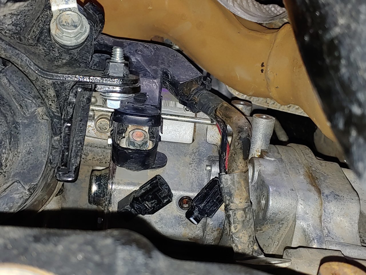

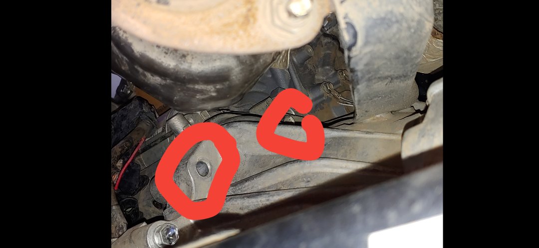

    These the bolts to take off starter? Got 1 out. Other is hard to access. Capture+_2020-04-06-18-13-21.jpg

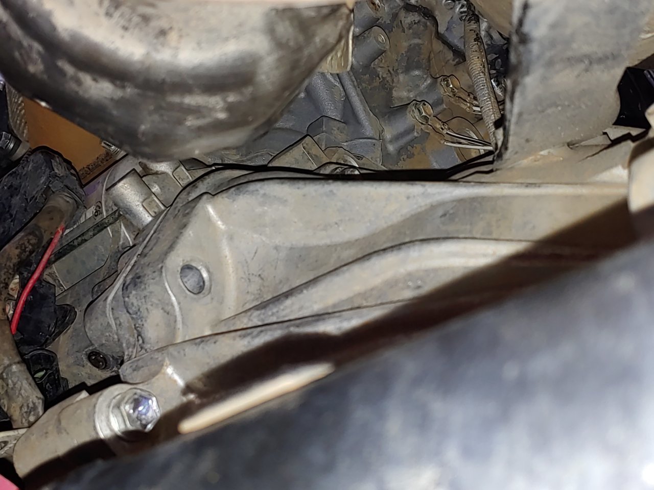

    Better pic

    Are you going to pull the starter apart to clean the contacts?

    Somewhat
    Like disconnect the two cylinders?

    like getting to the armature and checking if it got contaminated. cleaning those plugs out is a good idea too.

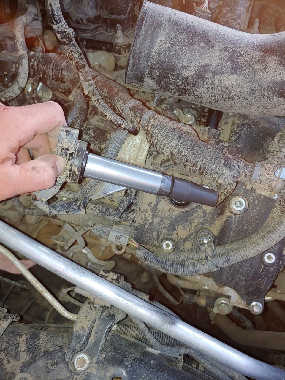

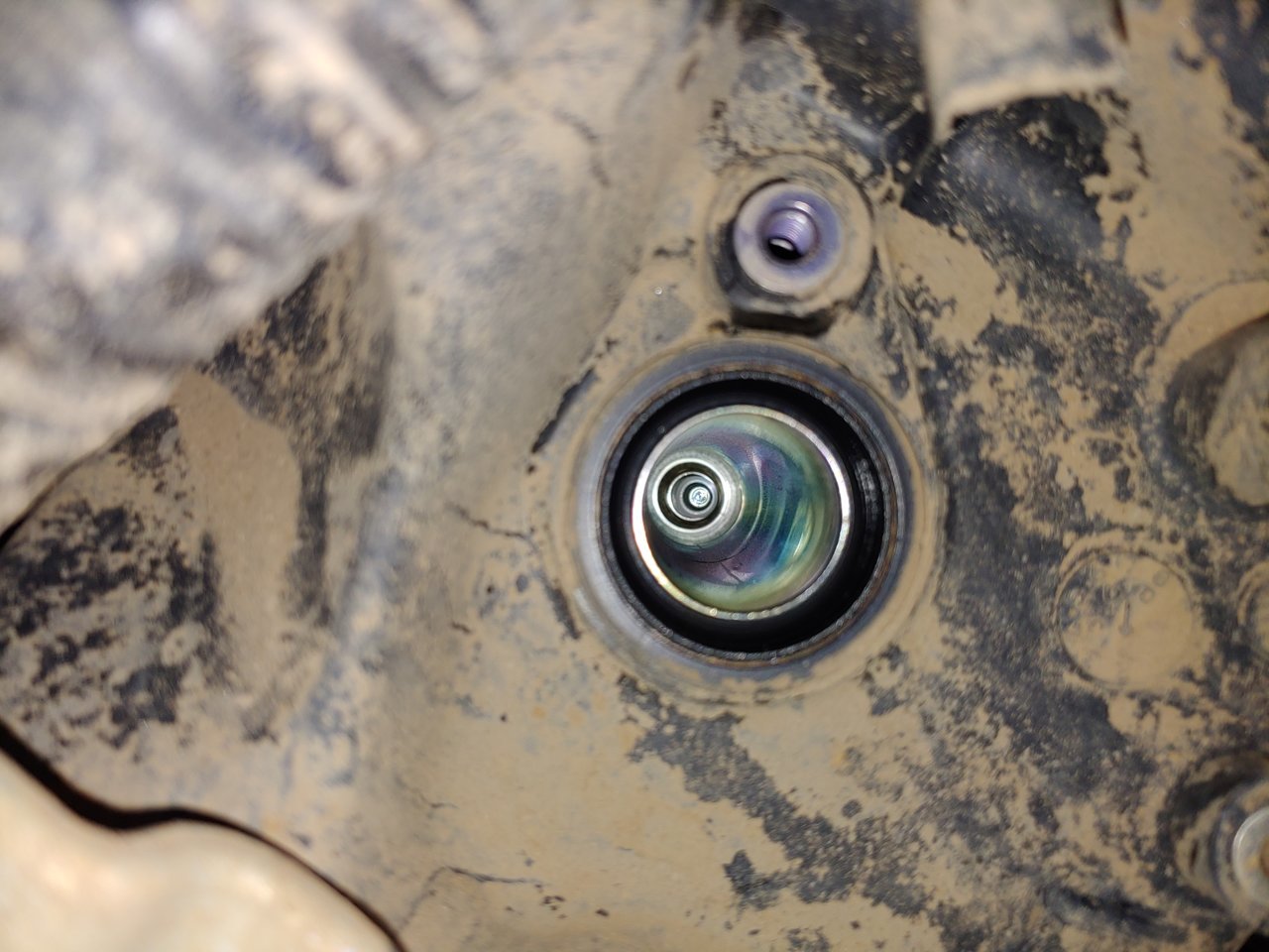

    I never thought toyota could make it harder to take a starter off the 3rd gen than the 2nd gen. Thanks boys.

    SOLUTION: sprayed carb cleaner all over the starter, including the starter positive amd negative terminals. Baby is running smooth.... Thanks fellas.
