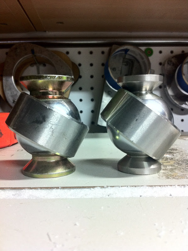

    Allpro on the left and camburg on the right (using some other spacers on the allpro ones till the ones below came in)

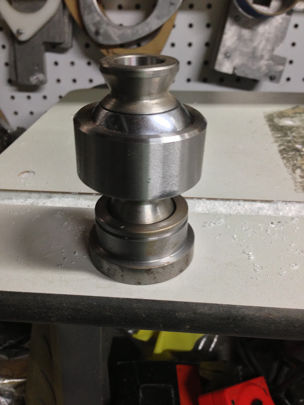

    and a pic of a uniball with 3/4" misalignment spacers and allpro slug
