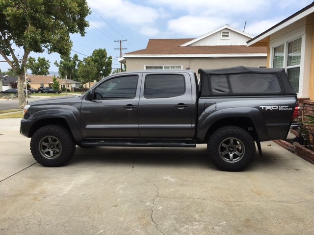

    5100's set at zero with Eibach coils (1.6" lift)
    1.5" multi-leaf AAL
  8. Jul 11, 2016 at 4:24 PM

    I lied, I do have a side shot. No VSC issues like I did with 2.5" lift and 285 tires.

    Measurements are 21.5" fender to center hub fronts, 22.75" rear. I'm using 265/75R16 and fender to ground is 36.5" fronts and 37.75" rear. Wheeler's Eibach coils, 5100's at zero, and Wheeler's multi-leaf AAL. I'm also using a spacer for the tacoma lean.
