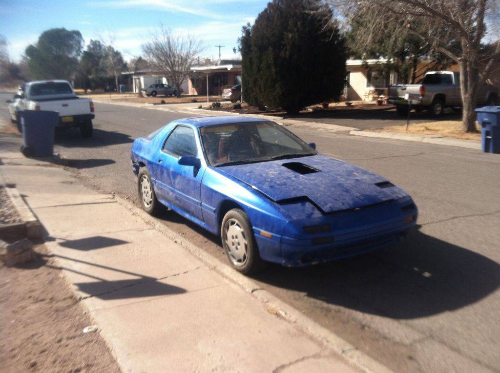

    So I picked up this car for $400 a few months ago. The body is pretty clean with the exception of a massive dent in the passenger rear quarter panel. The car had a SBC with a TH350 in it previously but had been removed before I picked it up. It did still have the granny's cradle in it 8)
    The car had:
    5 lug conversoin
    TII diff
    Hacked up harness
    Destroyed dash from sitting in the desert sun for years.
    You can see where someone cut up the mount. I welded in some new metal and re drilled the holes. Good as new.

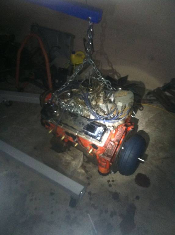

    Last night I tore the motor out of the truck, took me 4 hours by myself which seems like an eternity when you consider how simple this thing is!
    Got her all dressed up. New oil pan gasket since the old one leaked like a sieve, as well as a new rear main seal. Threw the Spec conversion flywheel, clutch, and T56 on there today.

    I got the motor in place in the car today but it looks like the oil pan is hitting the steering rack AND the granny's mount :mad: By then it was getting dark so I called it a day. The plan is to clearance the pan either with a hammer or by cutting and welding, really don't want to re do that oil pan gasket though... I hear some guys run washers to space the engine up too, sounds kinda sketchy to me.
