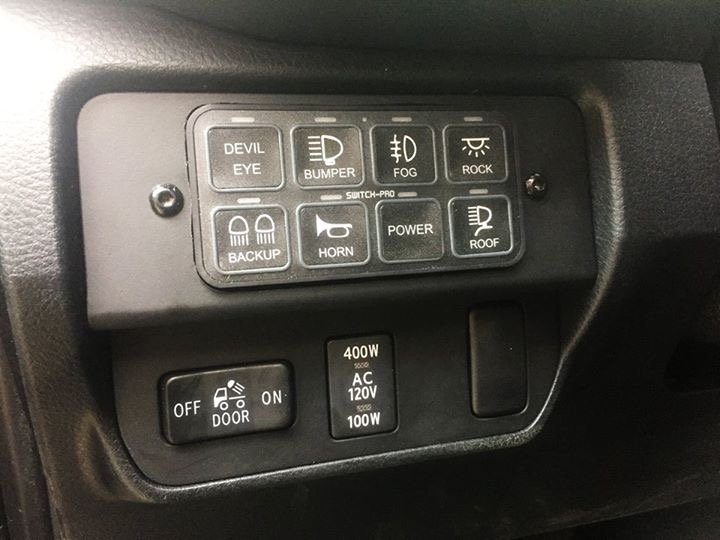

    Dash compartment served no purpose so I replaced it. Top image is my truck, bottom image courtesy of @ekimerpud.
    As for the people asking how to remove it, it's been two months so I hope you already got your answer, but if not here's how you do it. Pop out the lower kick panel (may want to pull the sill panel first). Unbolt the lower dash panel where the cubby is mounted in three locations along the bottom edge, the rest of the attachment is friction clips. From behind the panel you'll be able to see the four small phillips screws that hole the cubby in place. Done.
