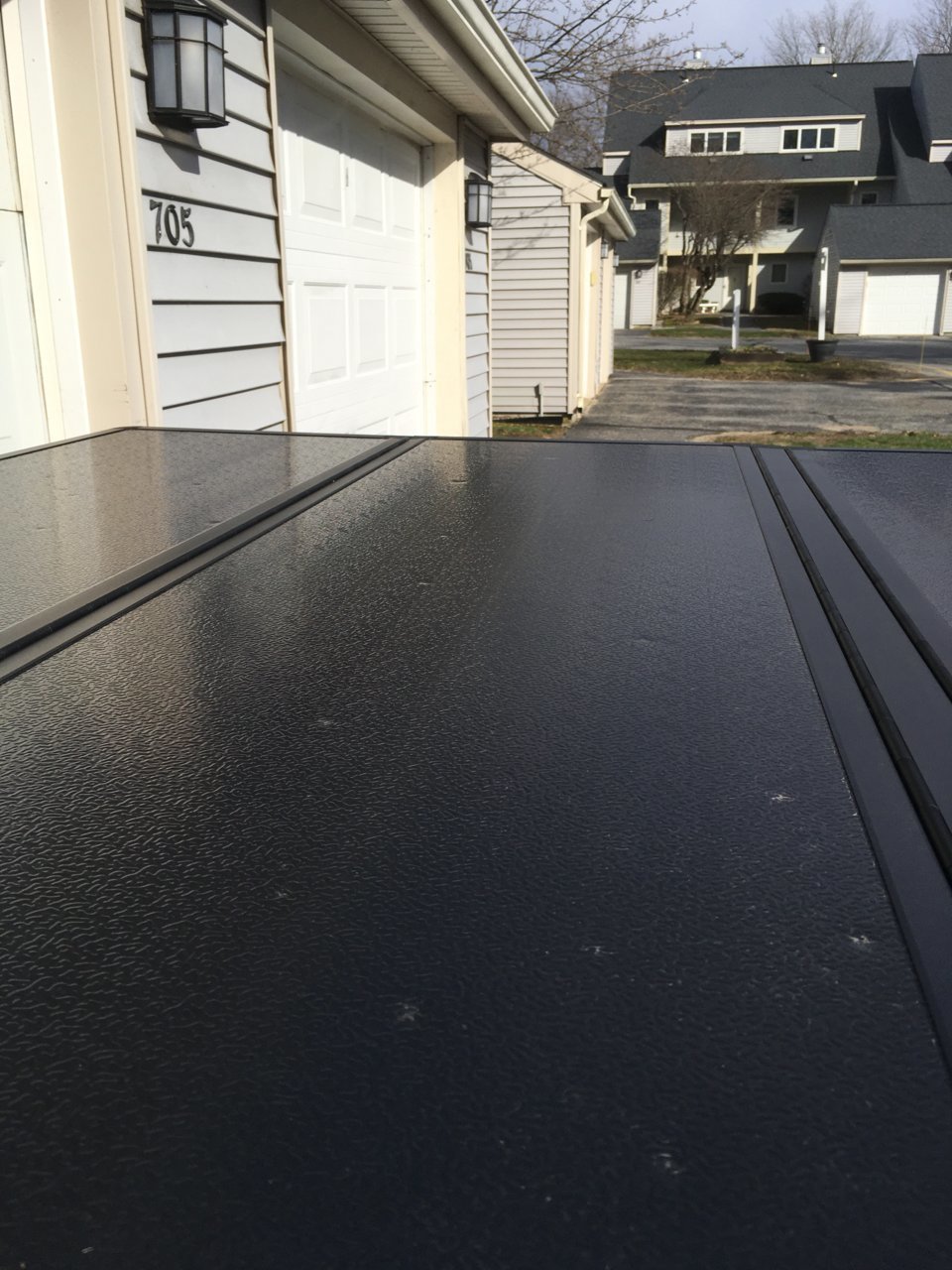

    I have a 2020 SR5 with a Ruggedliner hard tonneau cover. I have a bunch of small dents [believe it or not from dropped acorns - I witnessed it myself]. Any suggestions on how to raise / repair them? I tried a hairdryer but don't think it's enough heat. Afraid to try a heat gun as I worried it might melt the plastic and make it worse. Any suggestions would be helpful. Thanks.

    It was parked under high trees and there was no hail in the weather then. And no damage to the truck body, just random dents in the tonneau. I was literally was present and witnessed at least one acorn drop. F'in squirrels.

    The surface is not smooth [see pic]. Do you think it will still work on that?

    That's a bummer. Let's try 5nahaif's suggestion. Each dent doesn't look that wide though. It won't be easy to pull it out

    Wow, it's dented everywhere. Unfortunately not much you can do with aluminum. Park elsewhere I guess?

    No problem, it uses hot glue to stick to the surface. Just be advised you can over pull the dent. Once you got it how you want it heat up the glue with a heat gun to pull off the stud that it glues down. Then you can peal the glue off by hand.
    The glue it comes with is very strong, so if you pull too hard or dont take the stud off with a heat gun you will rip the metal or bend it even worse.
