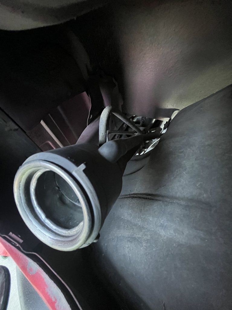

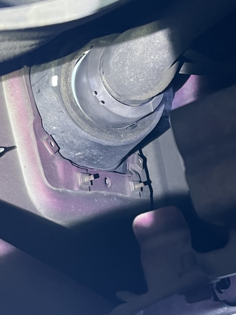

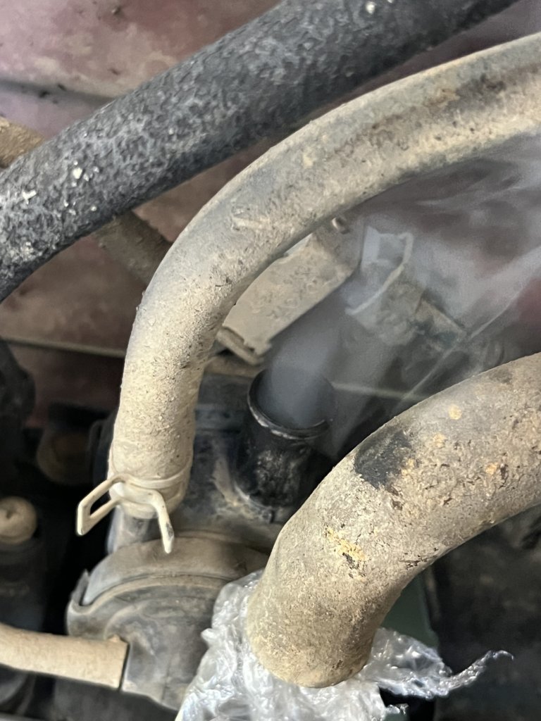

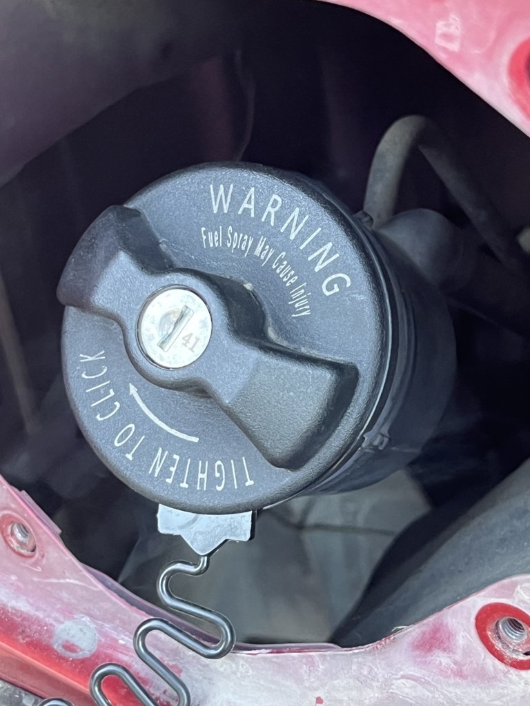

    IMG_3738.jpg IMG_3737.jpg IMG_3739.jpg Hey TW need some assistance here chasing a small evap leak code . Smoke tested and smoke coming from gas cap also from the back by filler neck sleeve . Do I need a filler neck hose assembly?
    gas smell coming from the gas door.
    See pictures
    TIA

    I would put a cap on it, clear the codes and let the evap monitor do its thing.

    This been going on for a few months now I swap out 3 different caps already no luck.

    Haven't dealt with this on a Tacoma, but isn't there an evap valve that vents on the filler hose area that you're supposed to close before doing a smoke test?
    I just did a smoke test on another car, and it poured smoke out the gas cap area, but it wasn't from a leak it was because I didn't jumper and close an evap valve there

    I've been getting the same code and started by replacing my engine bay evap lines. However, after reading more about it on Tacomaworld, I believe the issue was either the flexible hose between the filler neck and the gas tank (77213-04020) or the seal between the gas tank and the fuel pump (77169-04010). I replaced both at the same time, so I can't narrow it down more than that and both had very obvious signs of corrosion/degradation. The hoses between the gas tank and charcoal canister on my truck are delaminating as well, so I'll be replacing those soon. But for now my CEL has not come back on.
    If you choose to change the seal between the gas tank and fuel pump, be very careful with the bolts. They're tiny. PB blaster and some very gentle coaxing are the way forward. I broke the head off one of the bolts and not sure how to get it out without emptying the tank since it sits flush with the top of the flange:annoyed:

    You have to isolate vent from system before you smoke it. Otherwise the smoke will pour from filler neck.

    Yea I pinch the vent hose coming from the valve on the canister and still got smoke

    Pinching the vent hose correct I did it both ways and still got smoke

    so I pinche the hose with pliers and I also put plastic on the valve was this the right way to smoke it ?

    Pinching sometimes isn't 100% effective. I like to take hose off and plug vent somehow.

    So plug the vent valve ?

    Yes. Make it mechanically impossible for smoke to flow through it.
