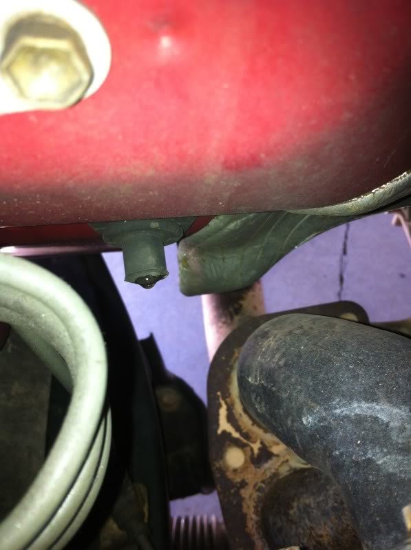

    Sounds like the drain on your evap box is clogged.
    Gently poke a wire hanger in the drain (from the engine side). It should dislodged debris and let a lot of water drain out that is otherwise leaking from your evap box and down into your passenger side footwell
    This is looking down the passenger side firewall in the engine bay. That black nipple with a drop of water on it, is what you're after. Yours might have a little 90* piece of aluminum tubing in it.
