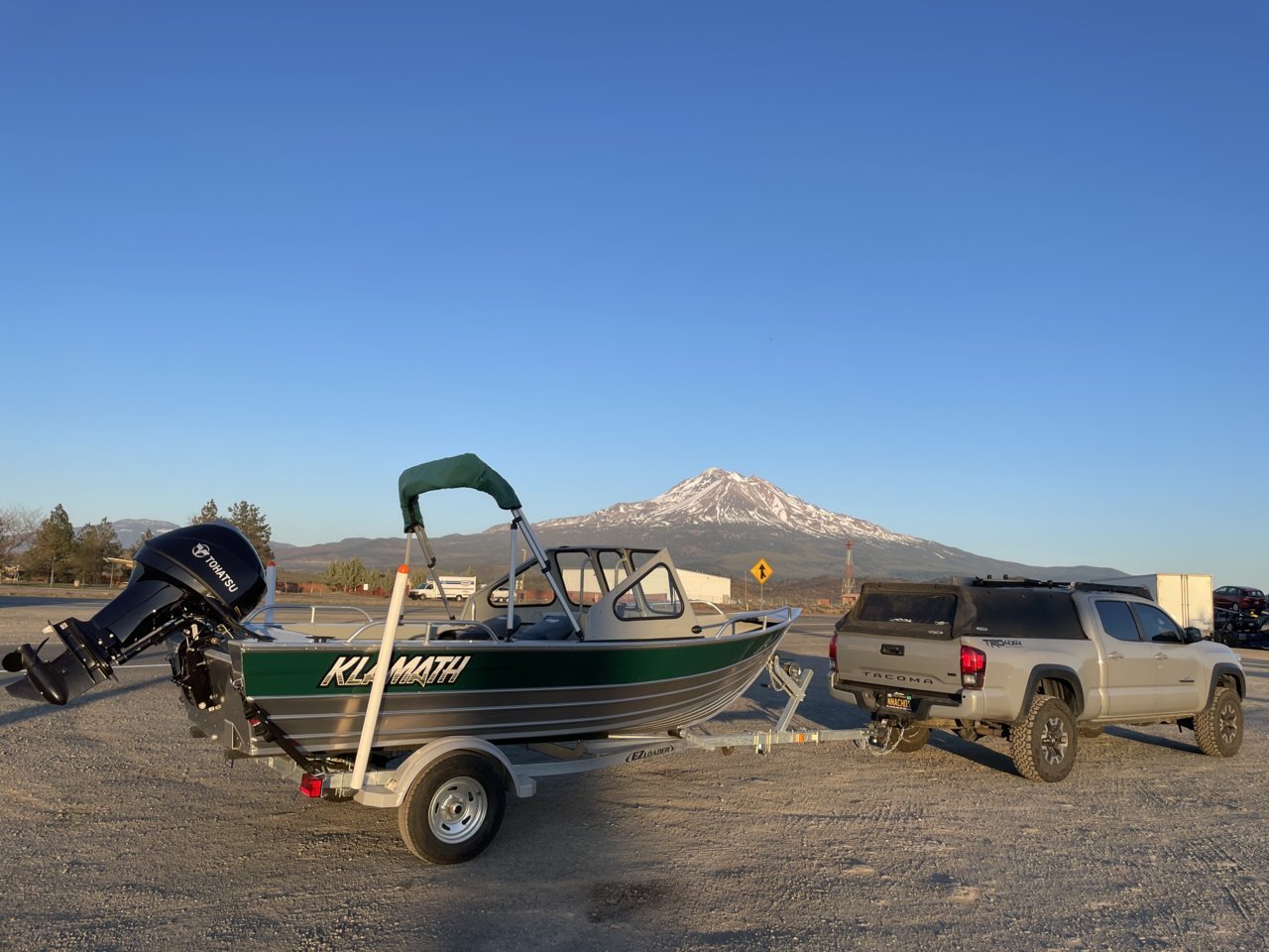

    Tow a 1000 trailer w/SMARTCAP and cargo in the bed. No squat and works great on the trail, desert. Solid.

    6112 5160s with OME med leaf pack(2inch lift). Not much sagged but it’s also an aluminum boat :rofl:
