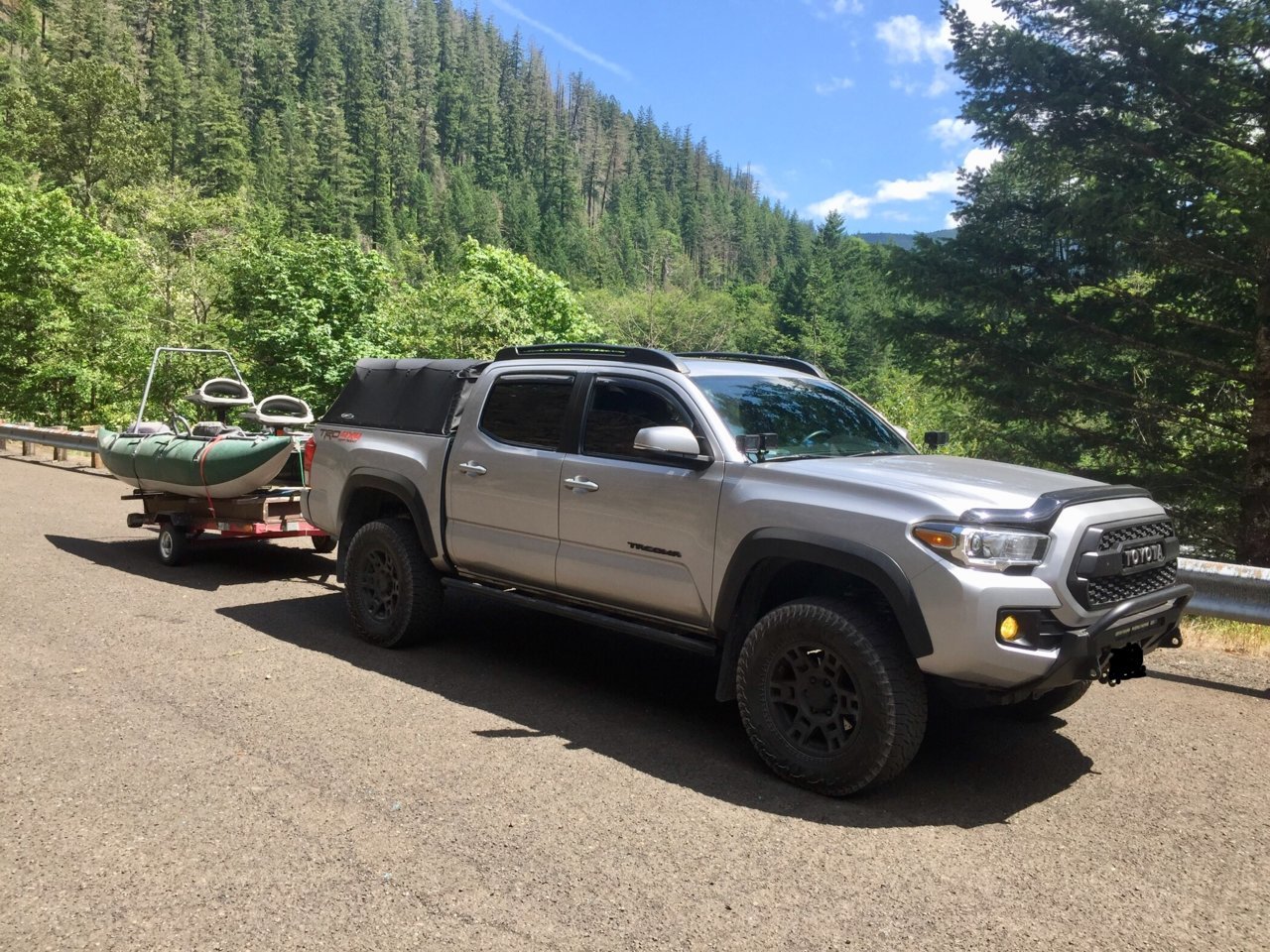

    2016 Quicksand TRD Offroad
    5100 at 3th perch (1.1"), 1"block rear. Slight rake. Just right for me.
    265/75-16 Wildpeaks.

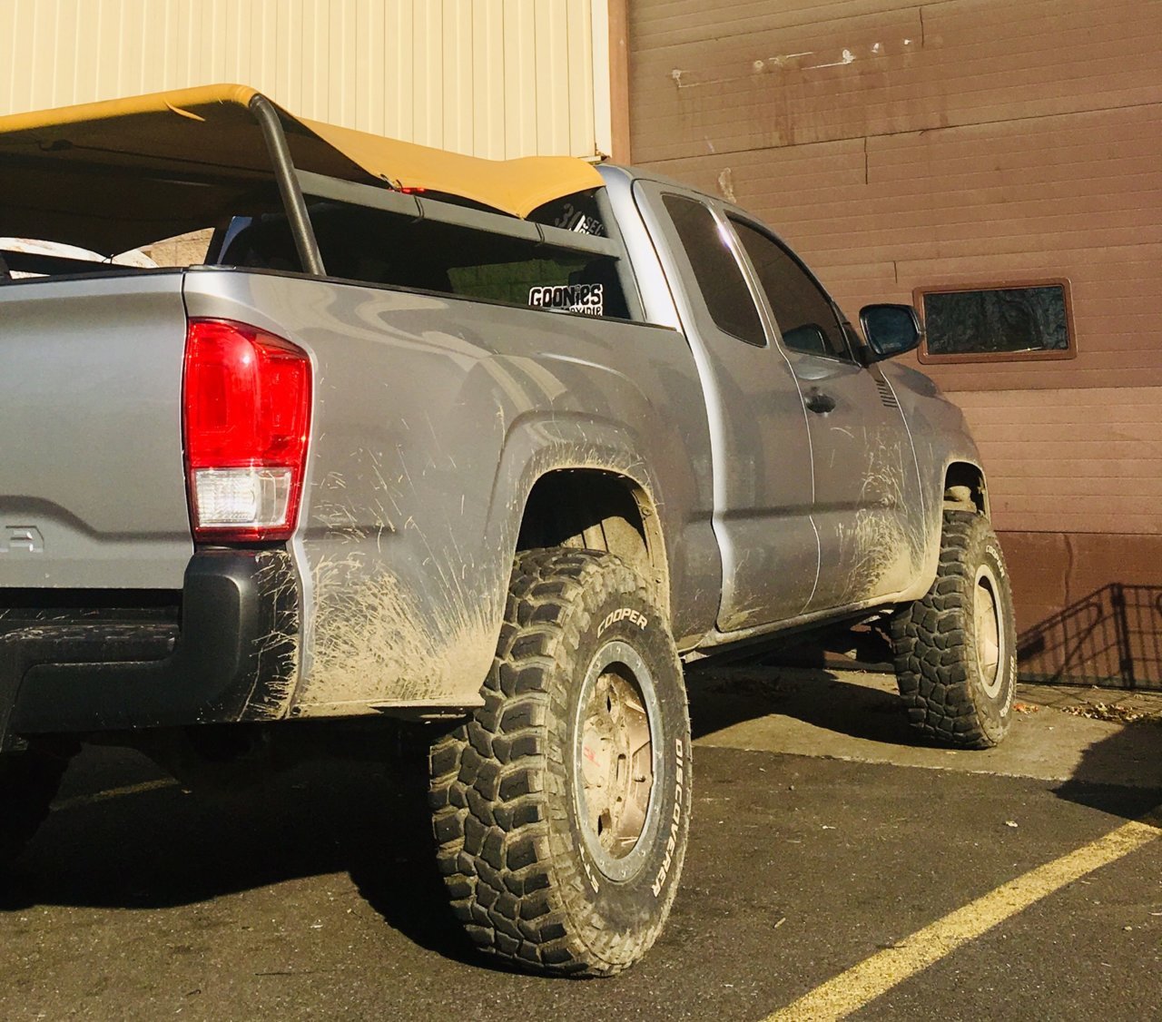

    Aaronski
    Tacomas.
    17 4X4 sr5spd/01 LT sr5spd
    265/75/16 and toytec 1/2” top hat spacers. Brings the front up 1”. Ignore the rear. When the oem shocks shit the bed, upgrade to adjustable/rebuildable.
