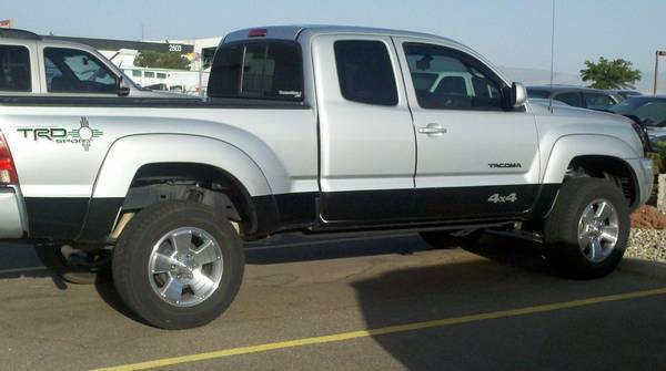

    No uca's needed with this combo. My brothers 07 came out perfect just needs one series bigger tires (265 70 17)
    eibach coils
    5100 @ .85
    2'' rear AAL
    I researched this combo for weeks, and had multiple conversations with toytech before buying. My brother wanted a lift and didn't want uca's or problems with vibrations and wanted alignment to be in spec.

    I am super picky about this kind of stuff and when i drove my brothers truck it drove perfect. I dont know how much more in spec his truck could be. This is why hewent with with the eibach/5100 setup. The alignment tech we went to knew his stuff and had and excellent rack. I guess we lucked out.
    If u r going to buy ucas go with a 3" lift. Imo
