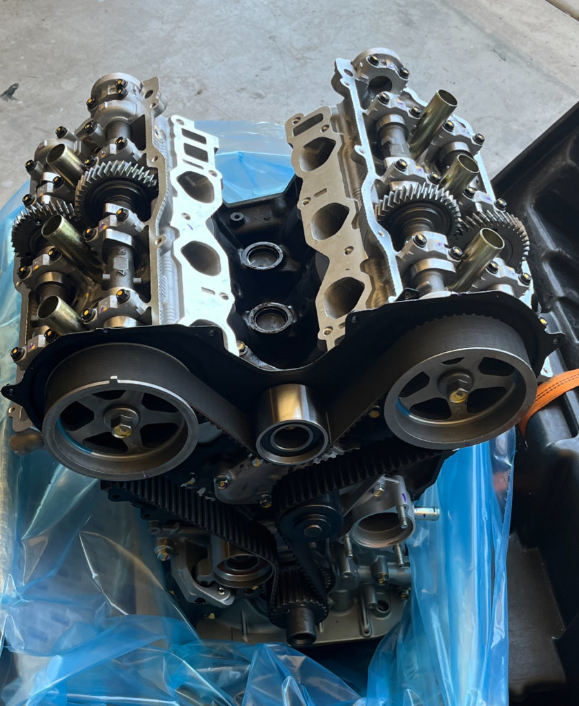

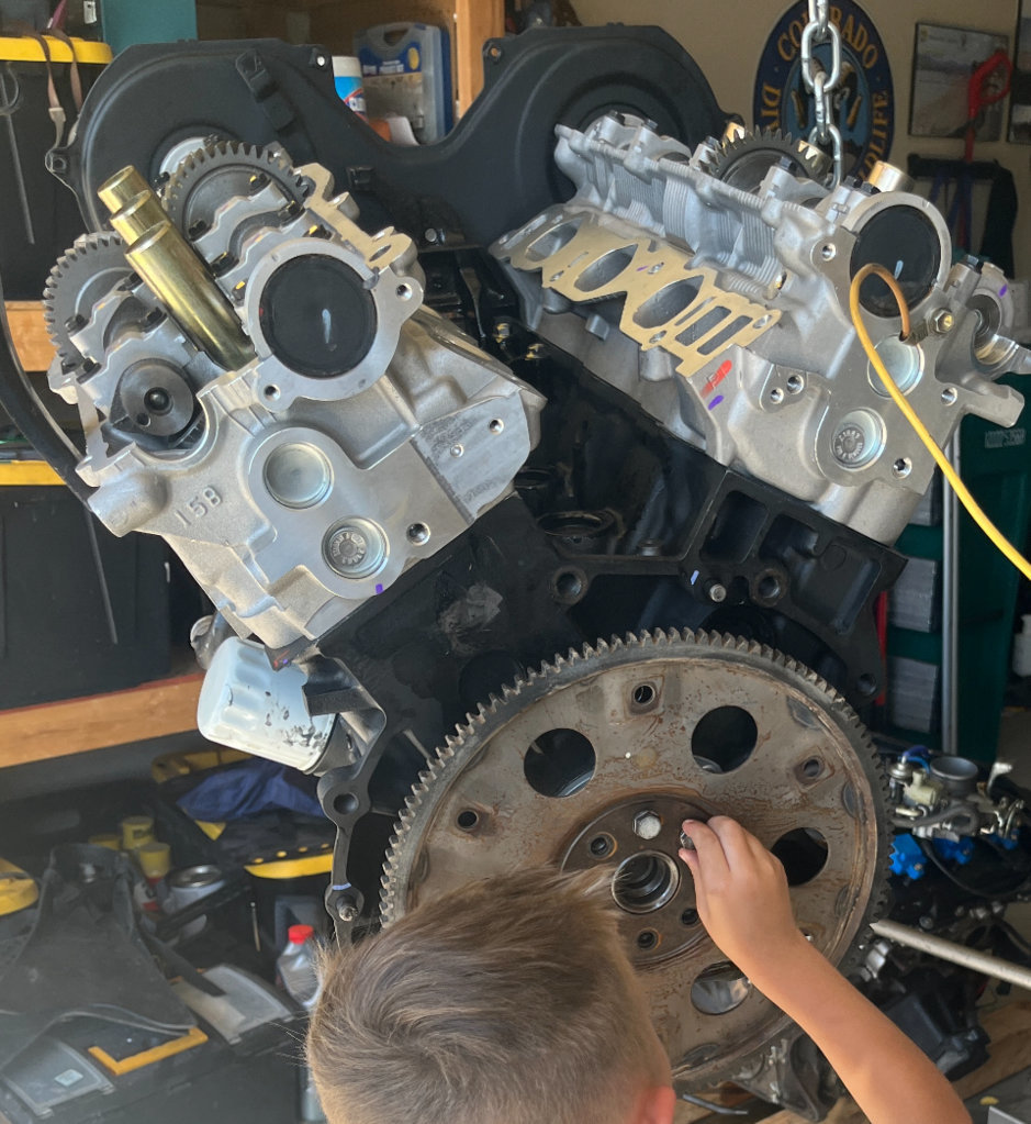

    I need a little help advice for my 1996 Toyota Tacoma. I just installed a remanufactured engine from car parts planet. The engine looked clean and great when I got the engine and the install went fine. The engine came with both heads already in place with the timing belt and the camshafts already on. I noticed whoever attached the heads to the block had marked every single bolt on the engine with a paint marker including the head bolts which I believe indicates that the bolts were torqued correctly and then “marked” to show they were torqued down?
    The head bolts all had paint lines on them across in one direction which makes me believe that whoever put the head on when they built this engine followed the instructions to tighten the heads to 25foot lbs then 90 degrees each bolt then another 90 degrees. So in theory they should all be marked the same way, which they were.

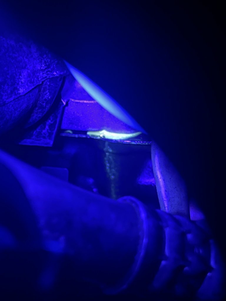

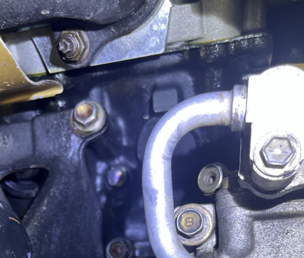

    I was able to start it and did the first 20 min break in and currently working on the 500 mile break in. I have driven it about 2 weeks and about 170 miles since I installed the engine and noticed a very small oil leak. I put some UV leak detector oil into my engine oil and have ran the engine about 20 miles and a few days. I fixed what I could but noticed a little oil leaking from between the head and the block in one spot on both sides of the engine. It’s not terrible but enough to leave a little oil on the ground wherever I go. The oil isn’t constantly leaking only during idle or after I drive.IMG_4101.jpg
    It’s not pouring out but definitely frustrating with a “new” engine to have an oil leak. It’s not leaking into the antifreeze and no bubbles are in the antifreeze or antifreeze in the oil. The exhaust isnt blowing any white smoke out like it would if the head gasket was leaking into the engine.
    So the question I have is what do I do to help with the leak? In my head I could try to tighten the head bolts but am concerned for obvious reasons of over tightening the head bolts and causing damage. Any help or advice would greatly appreciated.

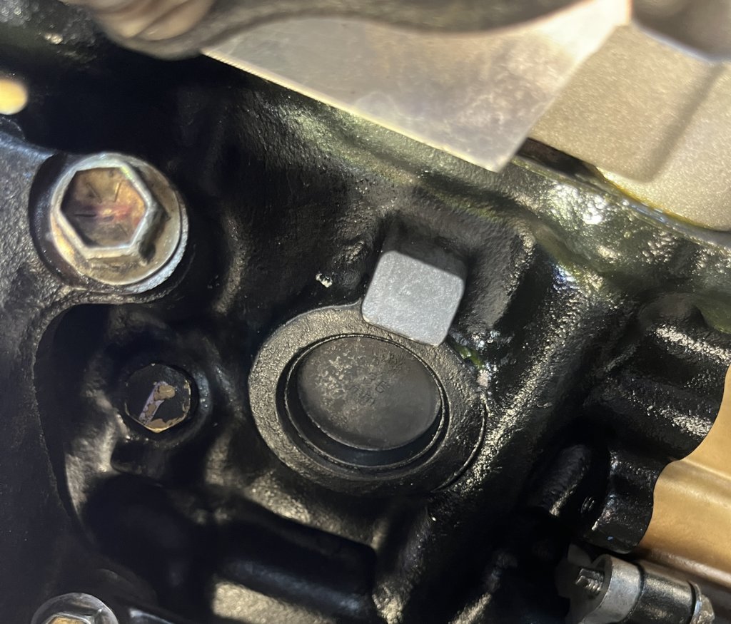

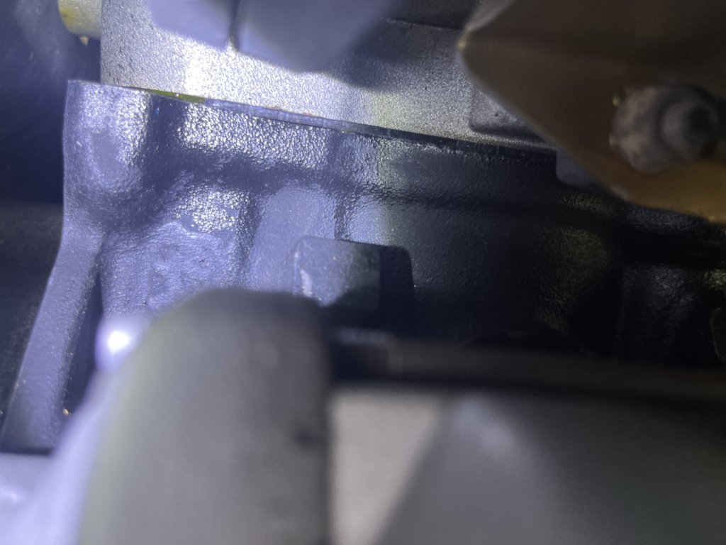

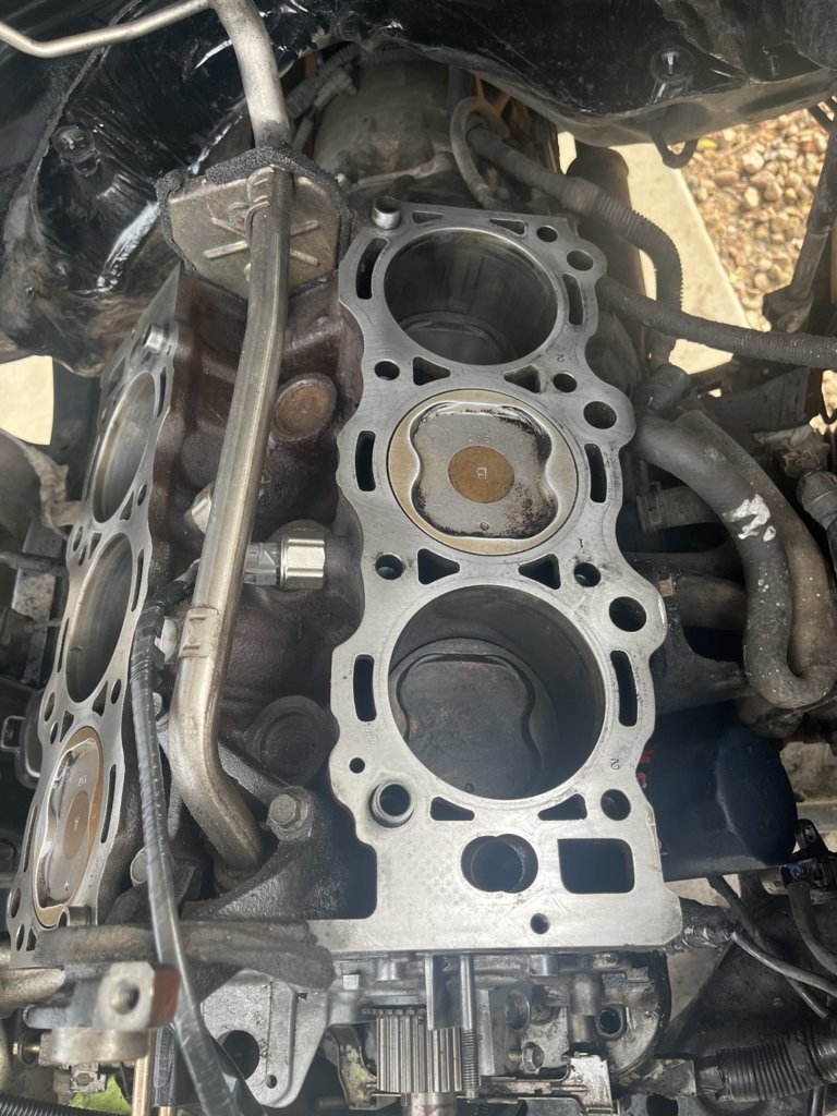

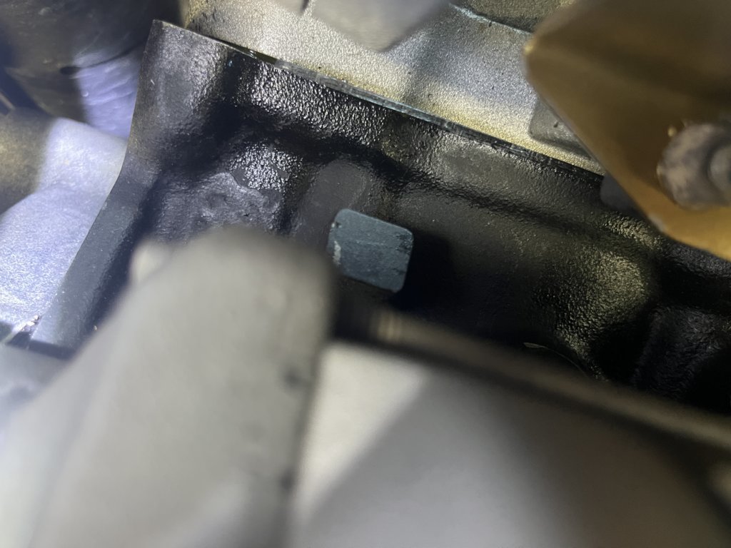

    I sent the pictures above and the pictures below which aren’t great because of location but show the oil coming out between the heads (Silver) block (black) and the oil running down the block.
    I’m not getting any engine codes. I don’t have a great picture of the oil leaks on the ground because I parked over gravel and have cleaned up the spots. The oil only leaks when the engine is running like in Idle or after it was running which makes since with the oil is all in the oil pan when the engine is off and when running, the oil obviously is pumped up to the top of the engine.

    If any constellation, 1st two pix……gasket just doesn’t look right….big gap….head appears to bend down to mate to block
    I don’t have 3.4L so can’t confirm
    wrong gasket? Mixed up R/L gaskets during assembly?
    Does manual say to place RTV on those seepage positions ?
    hopefully a member with v6 can confirm or deny the same

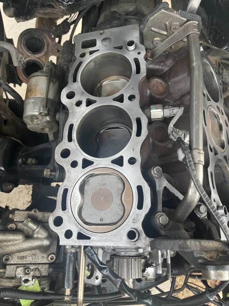

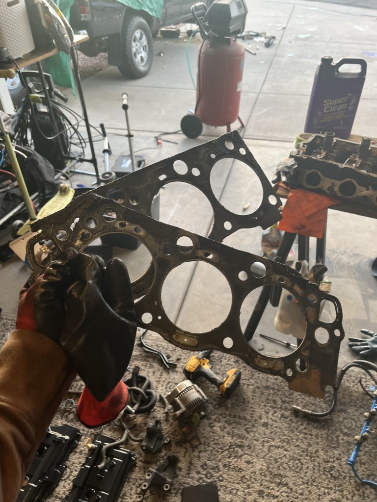

    Below is what the 5vzfe block and head gasket from my old engine when I did the head gaskets last year. I see what you mean about the heads kinda bending down in those two pictures and I really think it’s an optical illusion. I will double check in the morning but really think just weird angle
    The other picture you can bearly see the L on the head gasket of the driver side. So I don’t think they got messed up but didn’t check if the other one said right so there might be a chance.
    I honestly never though of putting high temp RTV on those seepage point but might be a good enough bandaid until next spring when I can break apart the truck and just redue the head gaskets.
    No instructions came with the remanufactured engine so I have been piecing the best I can together with the yota1 break in process online forums and Timmy videos.
