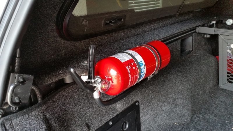

    What kind of carpet liner is that in your bed? That looks very nice.

    appears to be a bed rug
