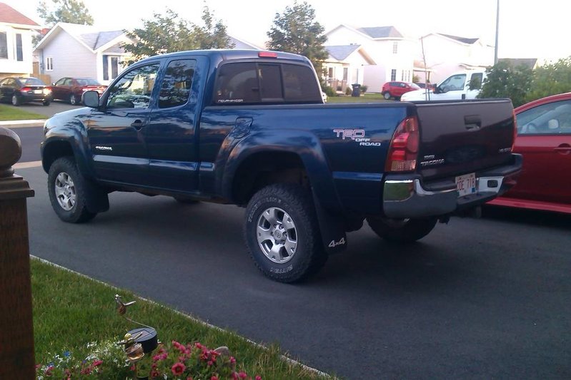

    I run General Grabber AT 2's at 245/75 R16 and I think they look fine, I'm lifted 2.5" but I didn't want to sacrifice mpg or power.

    I've never ran anything larger than 245, the first owner had 285's but sold them cause he didn't like it. 245 does everything I need.
