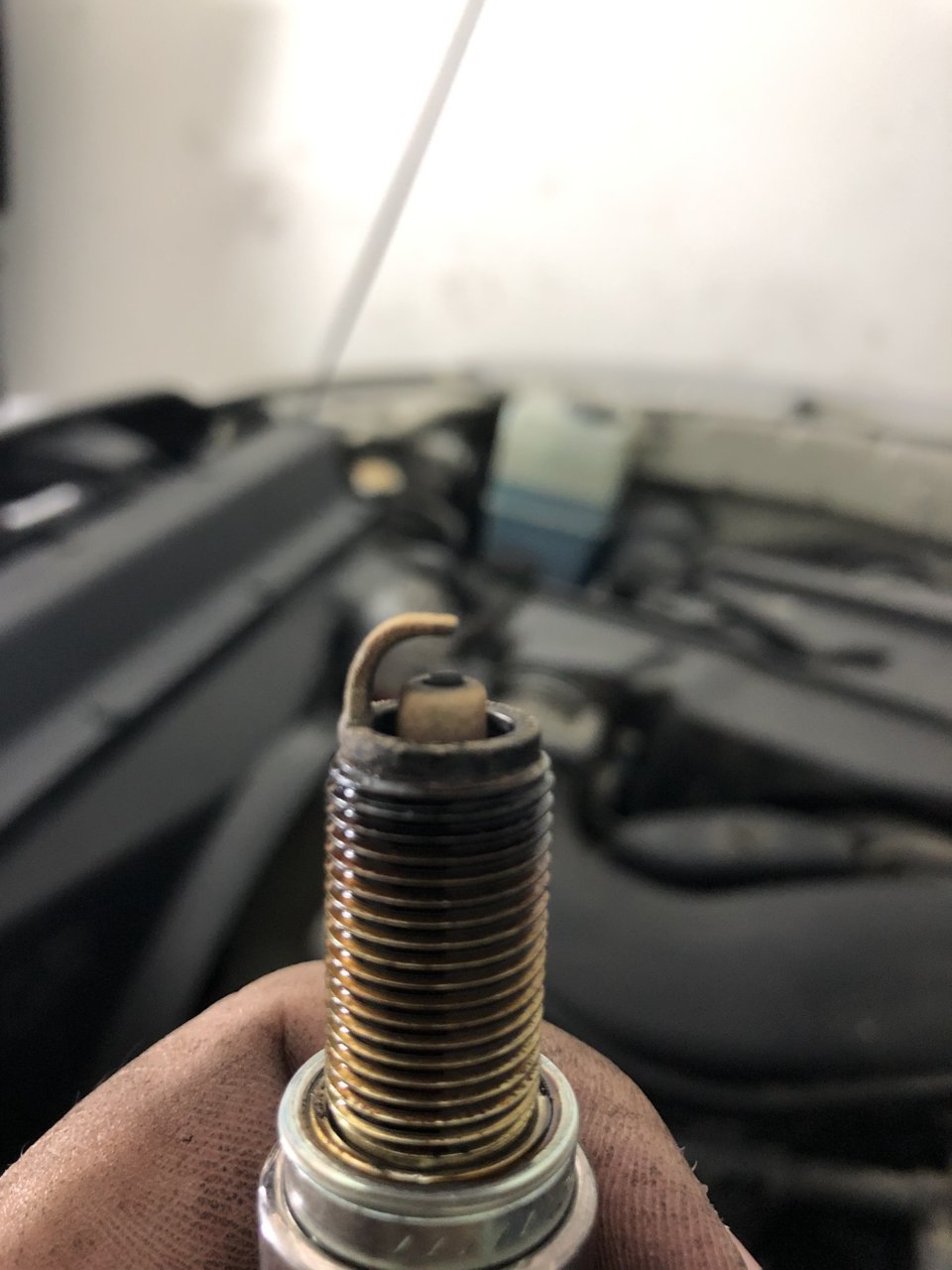

    I have to give Toyota credit.
    I’d say the coils are pretty robust on the 4.0
    I don’t get carried away with gap. I did my best to keep them at .040”
    But a couple thousands off I’m not too worried about. I say keep it as close to the OE recommendation as possible.
    Look at that gap……..:eek:
