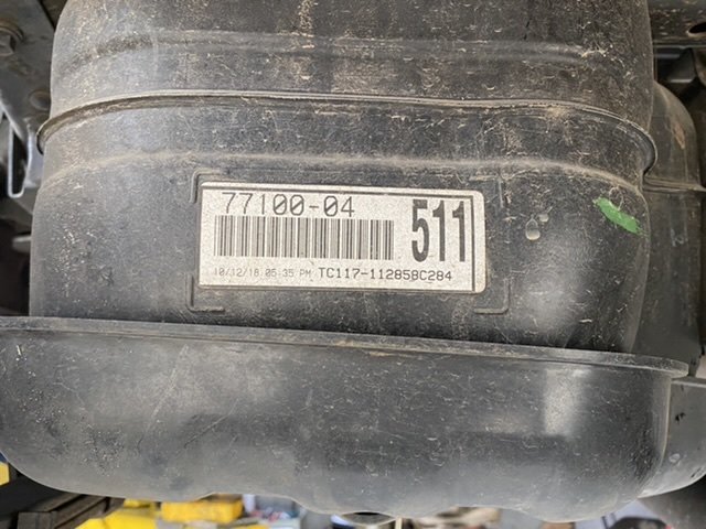

    This is my type of tank, any ideas? I look it and was perfect , also the shield that protects the tank was good2493B998-A4C4-40F1-A703-54CD146EC307.jpg

    That's fucking aweful lol what's your MPG? Mods? Weight? Did they repair the rear damage with a different tank? You have a picture of the entire underside of the tank so we can see how long yours is?

    Hi. Just steel rear bumper, 17inch wheels with 31 size mud tires, dnt know the weight of the car. They didnt repair the gas tank. I inspect it verry well. The damage was only the tailgate and bumper. It will be a hardcore damage is the accident would hit the gas tank.
