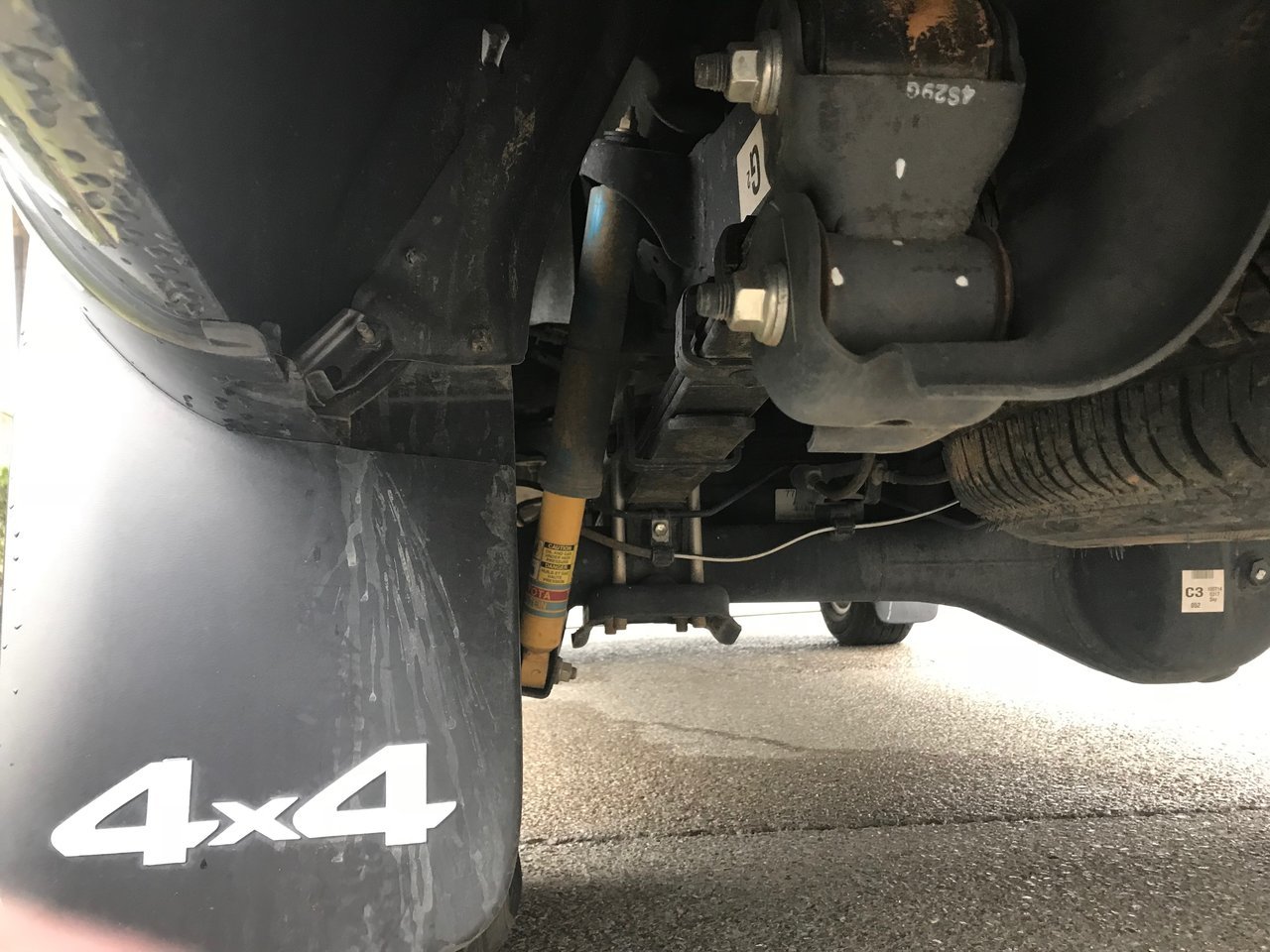

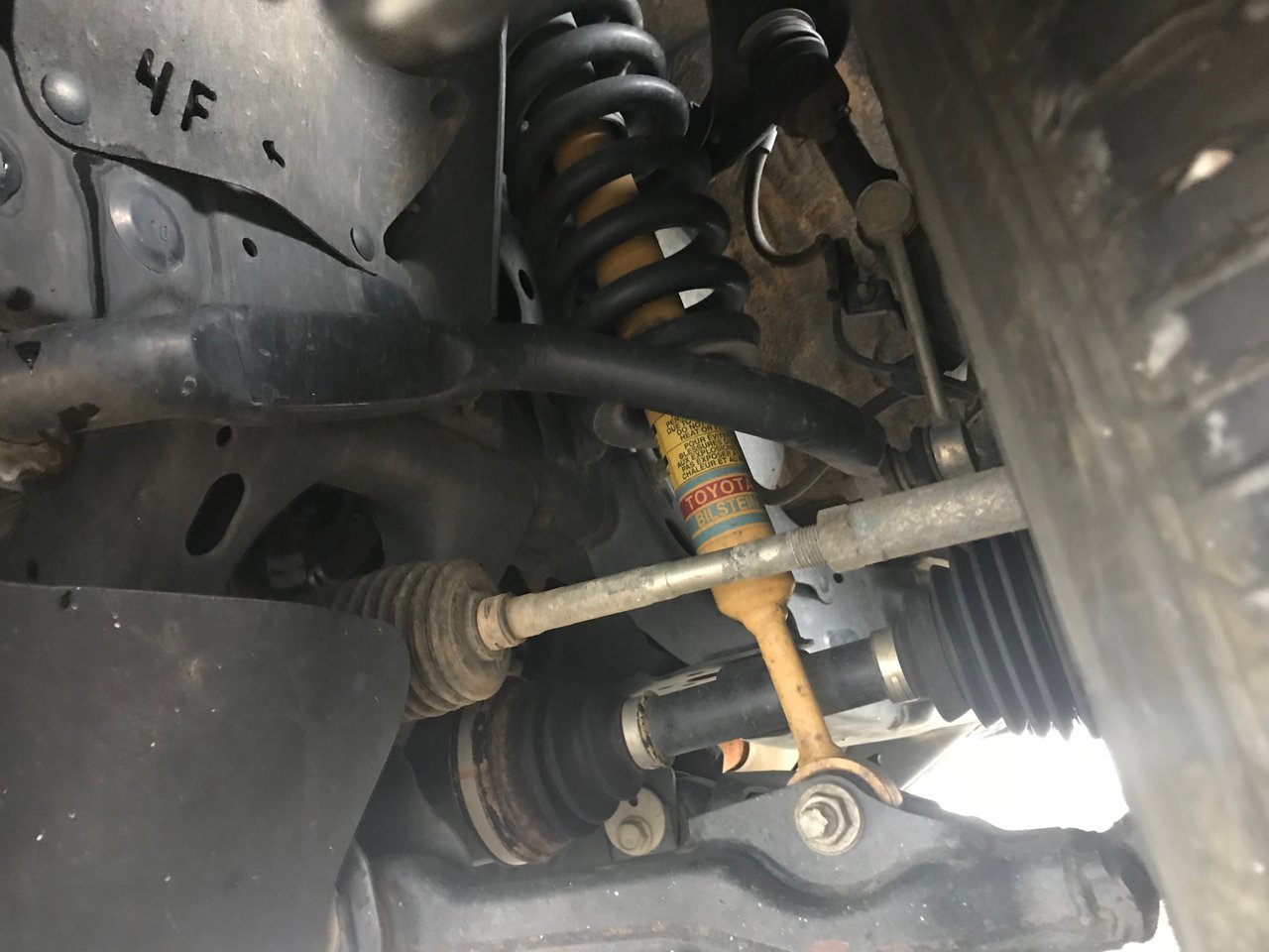

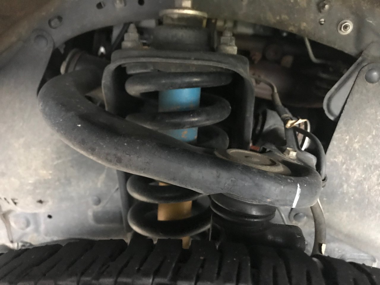

    My 2015 TRD Sport has the OEM Toyota bilstein suspension (pics). I think my heart is set on 5100's, but just in case...
    I'd like to lift my Taco 2-3" in order to:
    1. increase tire size
    2. increase approach angle and ground clearance
    3. improve ride
    (not necessarily in the order)
    I'm interested in smart options that are tested and reliable, rather than "opinions". It is my daily drive, but I'm planning on doing a lot more off-road in the future.
    Other stipulations include:
    1. proven functionality/durability (wont cause additional problems/wear)
    2. wont cause issues with needle bearing, bushing, control arm etc...
    3. I'd like to install myself, but I'll swallow my pride if it means avoiding "buy once, cry once"
    ChadsPride likes this.
