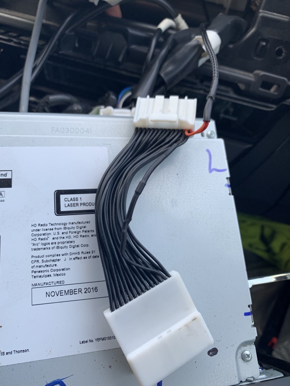

    On another fishing trip and it acted up again. It happened when it was raining hard last night at the campsite. The other thing that happened was the reverse cam was stuck on the head unit. Turned the truck on and off and it went away. I have the rear cam mod. I have left the switch on before and turned the truck off and did not have this happen. Maybe the diode is bad now or going bad sending a signal back to the computer and it thinks it’s in reverse. Gonna pull the cover off and unplug the rear cam mod and put it back the way it was. If it is not then I have a short somewhere from water.
  18. Apr 6, 2019 at 5:20 AM
    #38
    The Riddler
    The Riddler Well-Known Member
    Feb 28, 2013
    #98696
    128
    Boston, MA
    17 Sport
    BF931FD1-0557-443C-96D9-3C76CE76C2D7.jpg Pulled the radio out, unplugged reverse cam mod out of head unit and put it back factory and it’s still doing it.
    I believe it’s the drivers side door sensor for the Fob is shortening out. As soon as you hold the fob up by the window the blinking service light and key not detected turns but your power locks still won’t remote open and you can’t lock the truck.
