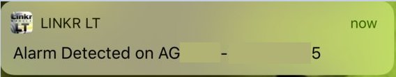

    Some folks are reporting getting this erroneous/false notification on their smart phone module (very few folks):
    It does not affect all, just a handful of units and does not mean you have a defective module, this is a manufacturer pushed server based thing. Certain batches get it, other's don't. We can fix it.
    If you're one of them, you have two options to stop it:
    A) Go to your PHONE'S APP NOTIFICATION SETTINGS (not within the app itself) and disable all notifications FOR the app. You don't need to worry about missing out on any other notifications from this app as it has none.
    B) PM me the last 6 digits of your device's serial (found on the device, sticker that came with it that you may have placed somewhere on your vehicle like door jamb, or easiest way to go into the app, open up the settings and either type it out to me in a PM or screenshot it). If you have my personal cell, feel free to text it if you prefer.
    Problem fixed.
