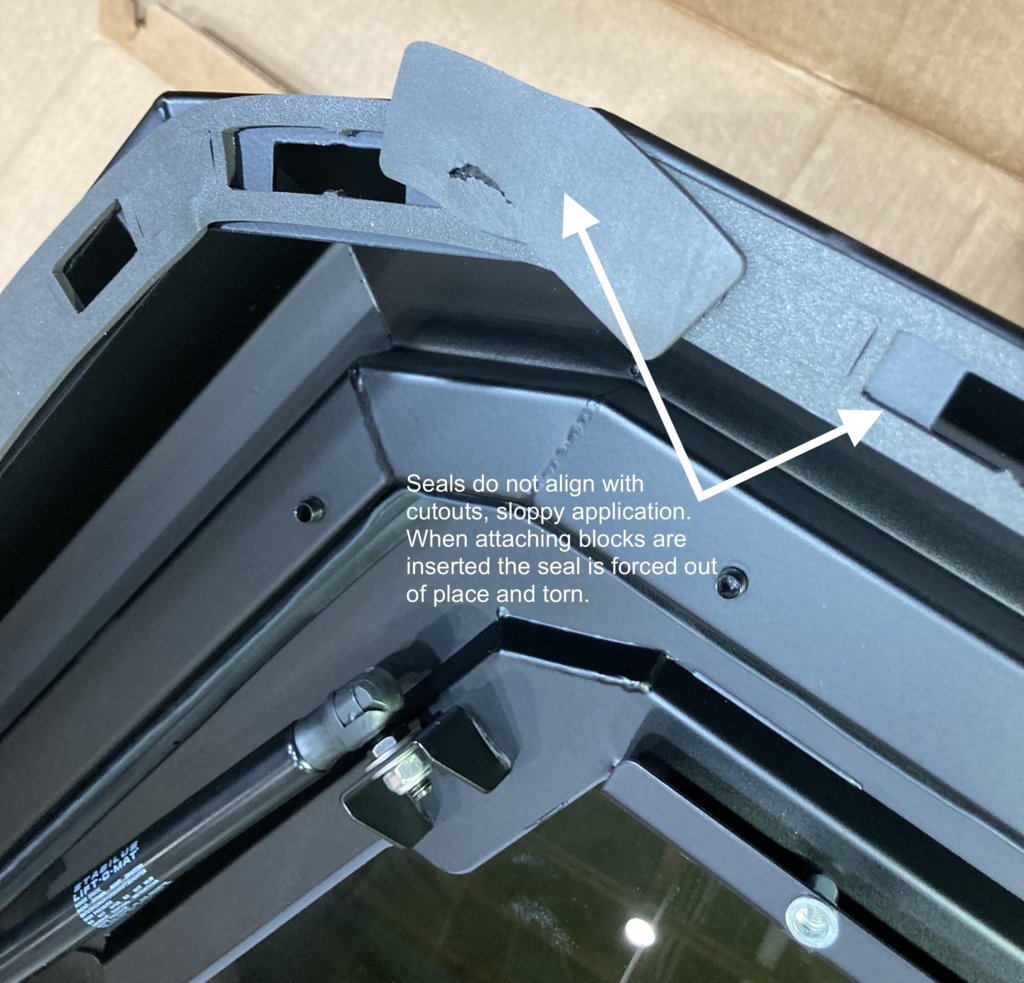

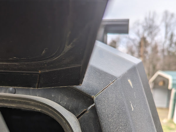

    I live in Washington state, rains a lot here and it started to leak at the seams. Don't want the hassle of having to resealing it, don't like the build quality, too many plastic parts. And.. down the road I might end up with this issue, grinding off welds for looks is not a good idea.

    Bought directly from RSI, self install. rsi smartcap leaking.
    I think they have a quality control problem, so you get a mix of good ones and bad ones.
    I just got unlucky, it wouldn't be a big deal if they would have just make it right.

    Have you talked to Smartcap about that open seam? Plastic parts? The only plastic I can think of is perhaps the door handle. What am I missing?

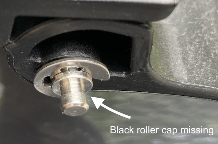

    Well, all of the nuts that hold the fore/aft structures together are plastic with thread inserts.
    The sliding windows have these tiny end rollers and slider springs that are held on with friction. (The end rollers were missing on my R/H window causing a jam.)
    I've been emailing smartcap for weeks, sent videos, pictures, etc. So far I've never been able to "talk" with anyone form Smartcap, the phone goes to voicemail.
