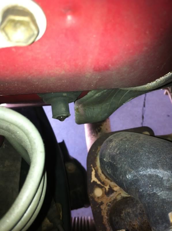

    Where is the drain tube? I’ll find it

    Passenger side firewall.
    Yours may have a small aluminum 90* elbow coming out of it.

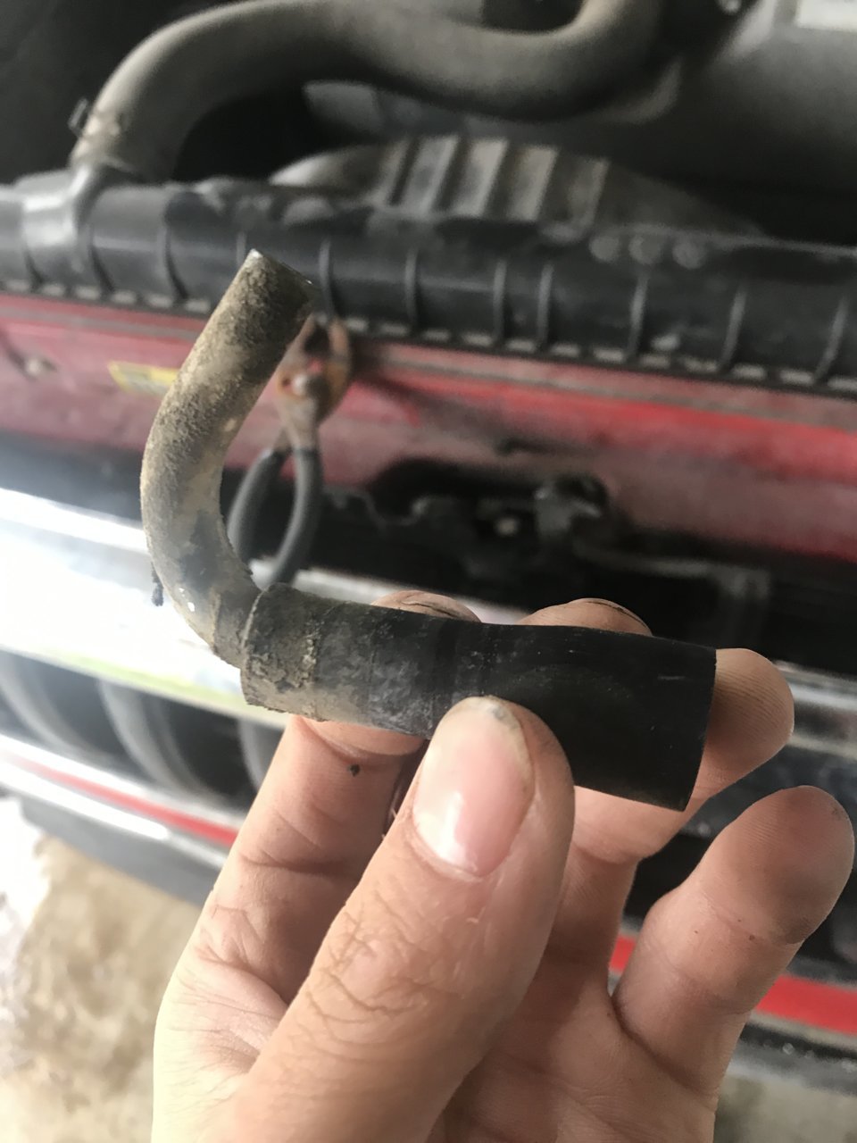

    Cleaned out there drain tube the best I could bring there’s that 90 degree tube on It. I lil bit of water came out

    You can pull that 90* tube out then clean it better.

    I bet it’s your evap box. Stagnant water/mildew
    After you drain it well you can clean the box with evap box cleaner to get the smell out.
