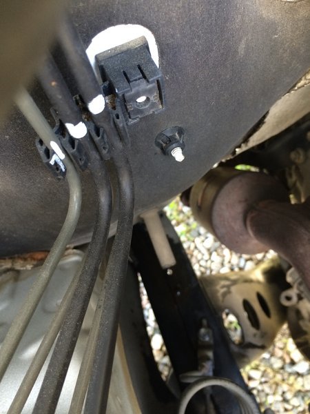

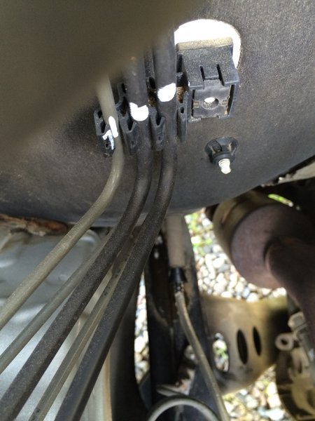

    This is the stuff I had, was given to me by a former Wurth sales geek. It is not an endorsement.

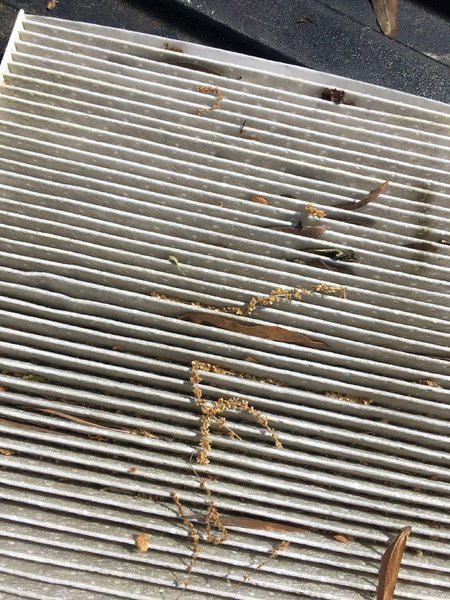

    Pulled my cabin filter out, was replaced back in August of '15, has maybe 7000 miles on it. Pretty damn dirty for the miles ( fwiw, the previous filter was caked so some of the crud here is possibly residual)
    Read the instructions...
    locate HVAC case drain hose on passenger side of firewall
    install fill tube and apply product.

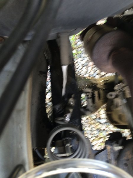

    the drain tube goes thru firewall and then hooks over to center under dash once inside vehicle, the blower motor is directly behind glove box and will not be effected by this process.
    and the resulting spew of yuck that comes out, I wasn't fast enough to catch the brown yuck
    after which I sprayed the air freshener can in the vent at the center of the upper fire wall while the blower was running
    it smell better in there, time will tell if it actually helped.

    honestly, the best thing that ever happened to an automotive HVAC system was the cabin filter. it may seem like a trivial PITA but it can save a lot of problems of debris clogging up the evaporator core. I've seen the entire core covered with a mat of leaves, wheat straw, general dust and nastiness. and once you're there, you may as well replace the part over cleaning it, the work has already been done.
    Cabin filters catch most of all the crap that gets into the HVAC system, AS LONG as they are maintained. a plugged up filter will not allow FRESH air movement, a clogged up evap core will not allow ANY air movement.
