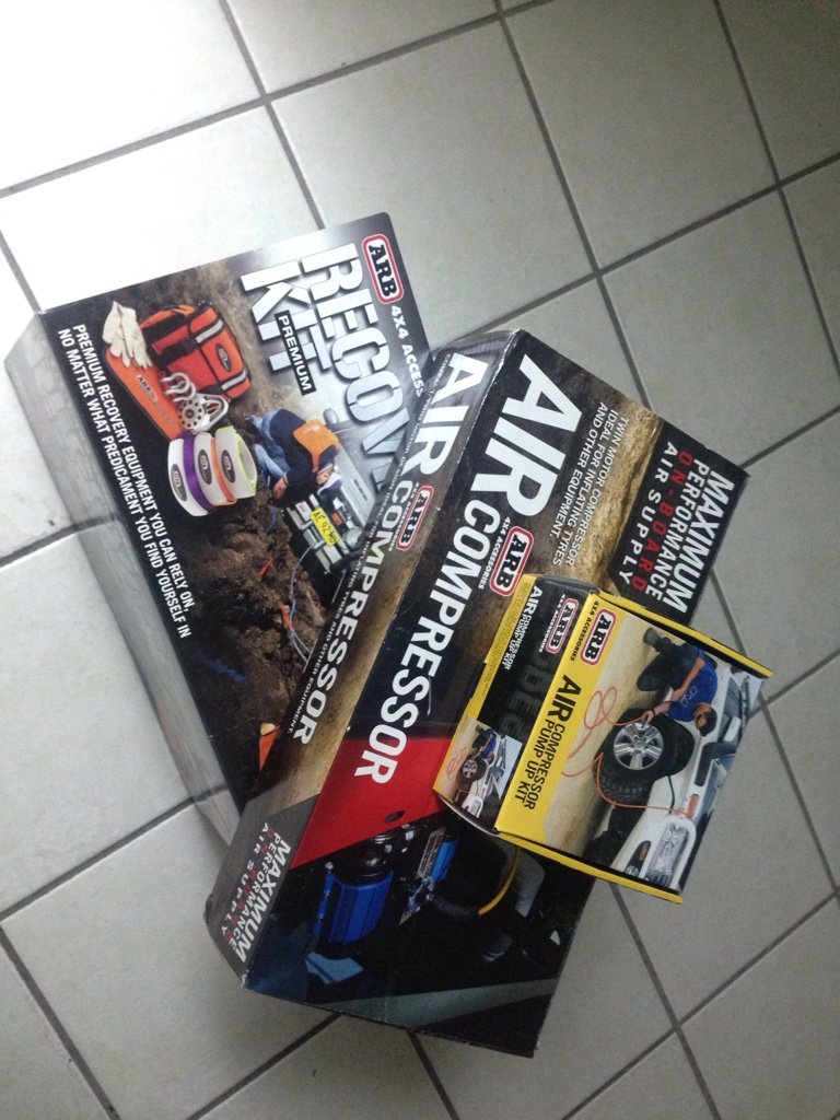

    DRR... I think im that guy with all the fancy recovery gear...:eek::eek:
    I got the ARB premium recovery bag thing for a steal and the hi jack (black friday!) haha
    I just wish like every other tw member i can wheel more and use this stuff to its potential...

    That's some nice gear you got there, Crazy. I have that compressor for my locker, it is pretty awesome. I don't know if there's much wheeling to do in Florida, but there's plenty of places to put all that stuff to use around here, let me know if you're up this way and we'll hit some trails.

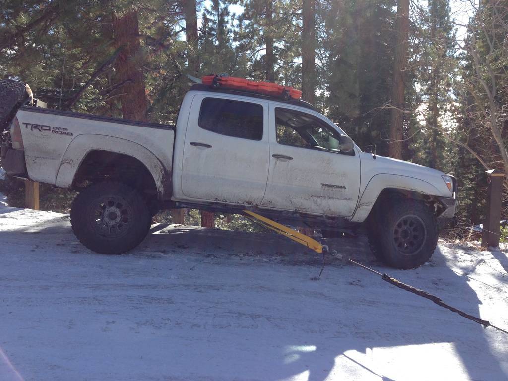

    I have used my X20 4 times now. Two of the times I used a snatch block to winch my truck and another truck completely sideways. I have had zero issues and I love the wireless remote. I hope the winch continues to perform the way it has.
