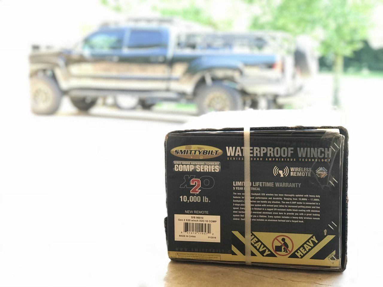

    Finally pulled the trigger and got a winch. Just waited for the best deal on this winch and just bit the bullet
    I understand how to install the winch, and how to spoil the rope and all.
    My question is I have seen people running a “winch switch” in the cab. Is this for power? Or for them to be able to operate the winch from inside the cab? I never fully understood why I always seen winch switches in the cab. But being able to operate in and out from the drivers seat would be nice, which this unit has a wireless remote, so if that’s what people are doing I wouldn’t need to run a switch in the cab.
    Just wondering
    Thanks TW!
