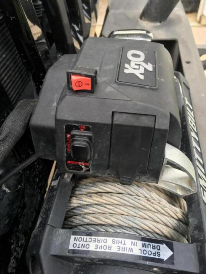

    The switch on the side of control box only turns off the wireless signal for the controller. It does not kill power to the winch.

    Are you talking about the little black switch on the solenoid? That's only to turn wireless on or off, not the winch itself from what I remember installing Joes winch. You can kinda see in this pic how it says "wireless" on the left of the switch.

    Yup. That is correct. I guess I need to find a cutoff switch now.

    Yesterday I installed this in a Warn hidden winch bumper, everything went well.
    The winch has a red off/on power switch on the top, so you can just keep it off when not using it.
    Correct me if I’m wrong
