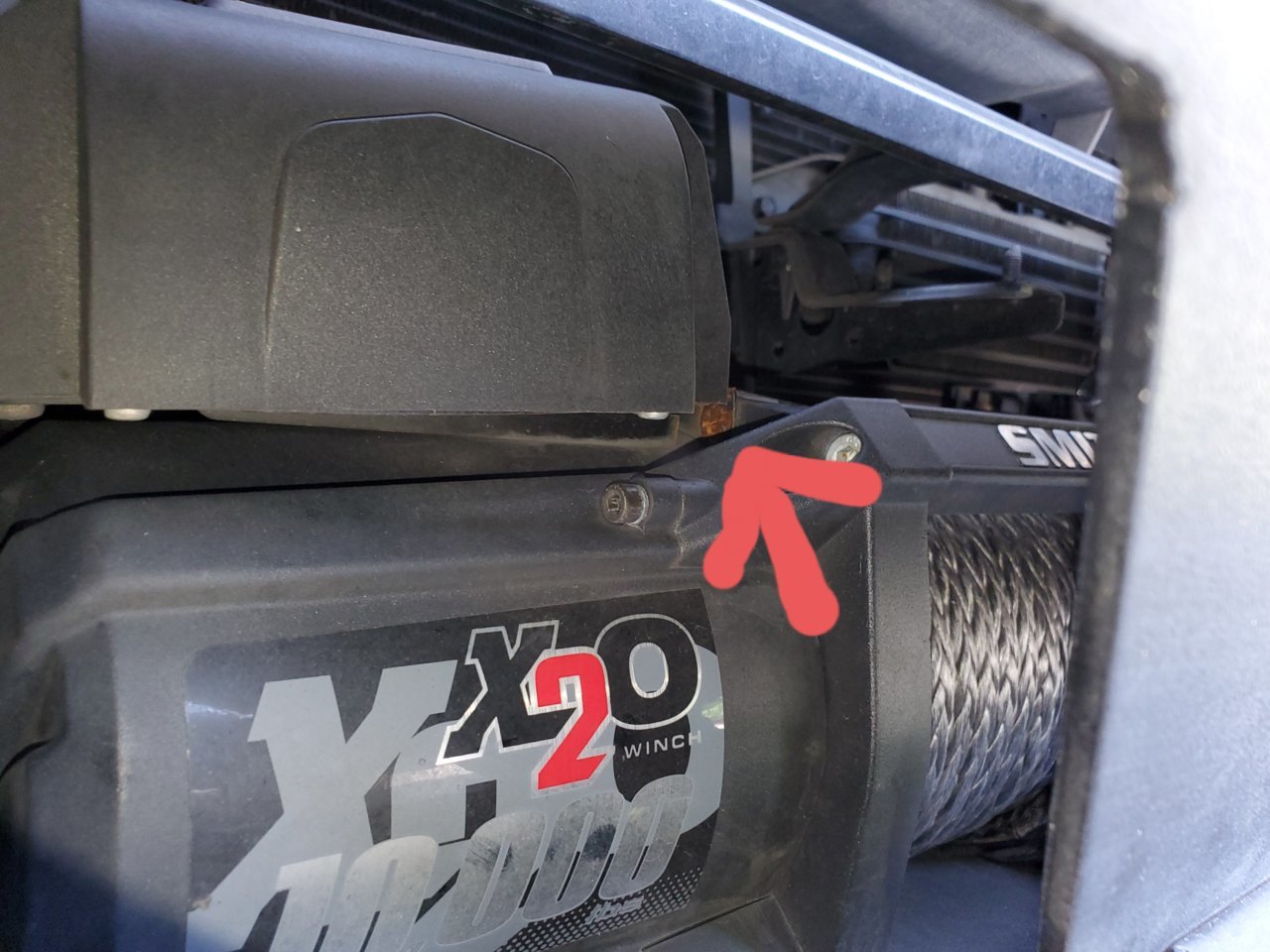

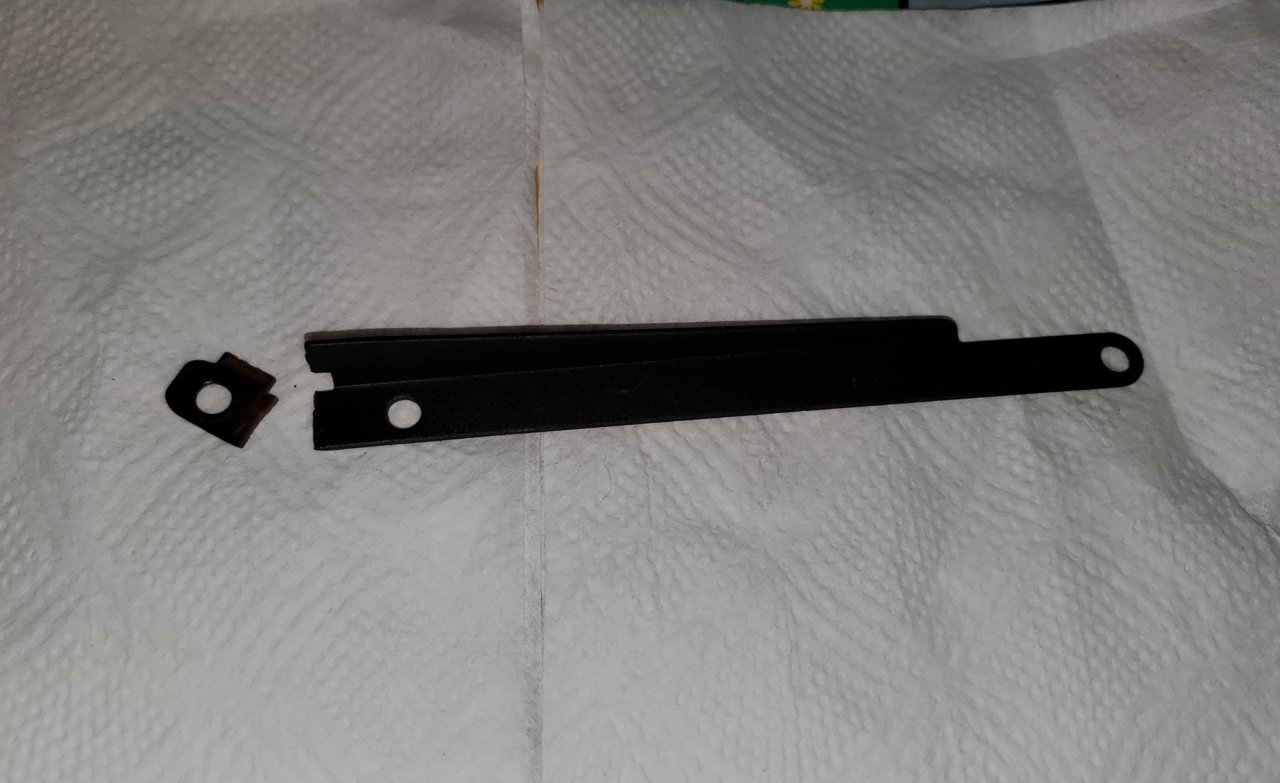

    New topic and heads up. I just noticed that the mounts for mounting the control box on the side have broken on mine. These are the little black mounts, not the shiny aluminum ones. Anyone that used these may want to make sure they aren't broken. Now I have to remount the control box.

    I used my center mount, if I can find my similar side mount, I'll send them to you

    Thanks for the heads up! I always thought that was a poor design in general...

    I agree, the gauge was thin and the one weld tack was, ehh it'll hold lol

    I mounted mine right in the middle and just trimmed that bracket with some sheet metal shears seems sturdier in the middle to me.
