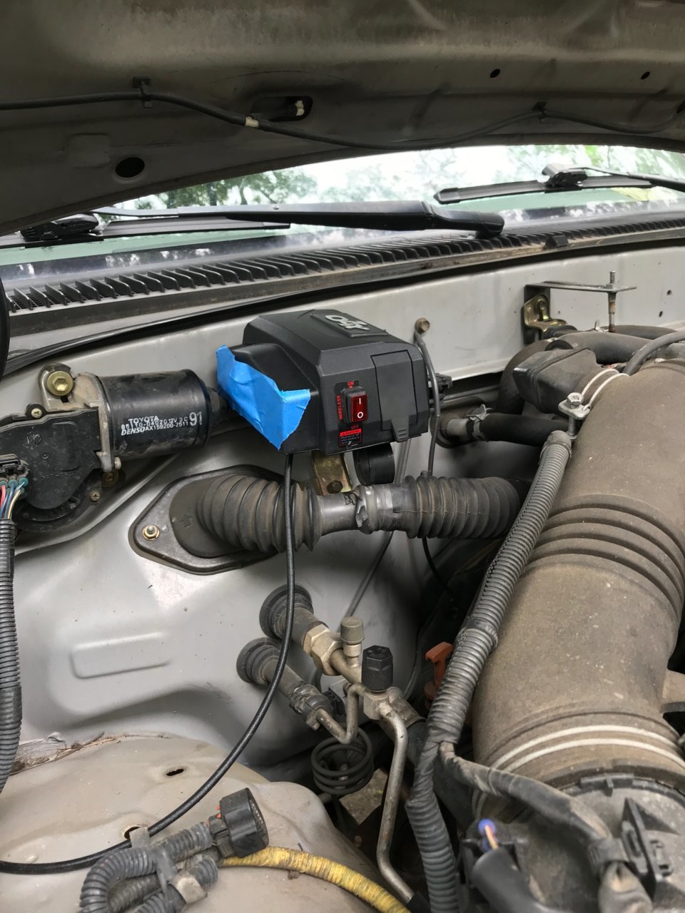

    Hey guys. I'm relocating my control box to under my hood. I have everything ready except 1 thing. I can't seem to find out what gauge the smaller "A" wire is. My guess is 12 - 16 AWG, but I'm not sure. Took it to Lowe's today and they weren't much help either. Anyone know what gauge this wire is? Or have any recommendations on which gauge I should purchase to replace it?

    Do 12 or 14 and call it a day. I started to do this, and then just put a switch in the cab.

    just to update, I called Smittybilt and they said it's an 18. I had already ordered 14 and 16 AWG. I think I'll use one of those.

    Also, still going to have a switch in the cab for the power interrupter, but this is just to move the winch control box to under the hood.61143268198__403156D7-AB03-4647-9DB4-0647A63D2218.jpg

    Haha not yet. I’ve got it pretty much done, just have to hook it to the battery and wire up the switch, been short on time lately
