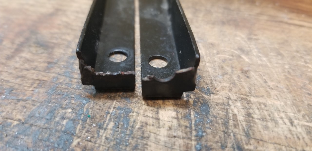

    Anyone have the part number so I can order new brackets? These rusted out after 6 months and left my solenoid hanging. Going to support the other end as I think the constant flexing is probably what mad them snap.

    6 months?!
    Do you take it swimming in the ocean or something?

    Not sure if you got these replaced yet but email Smittybilt they will send you out new ones. I have gone through two sets- the design is shitty. When you get the new ones buy a rubber drain stopper, cut it to the right length and superglue it to the bottom of the solenoid so it rests on the winch motor.

    2014 Super White Tacoma TRD
